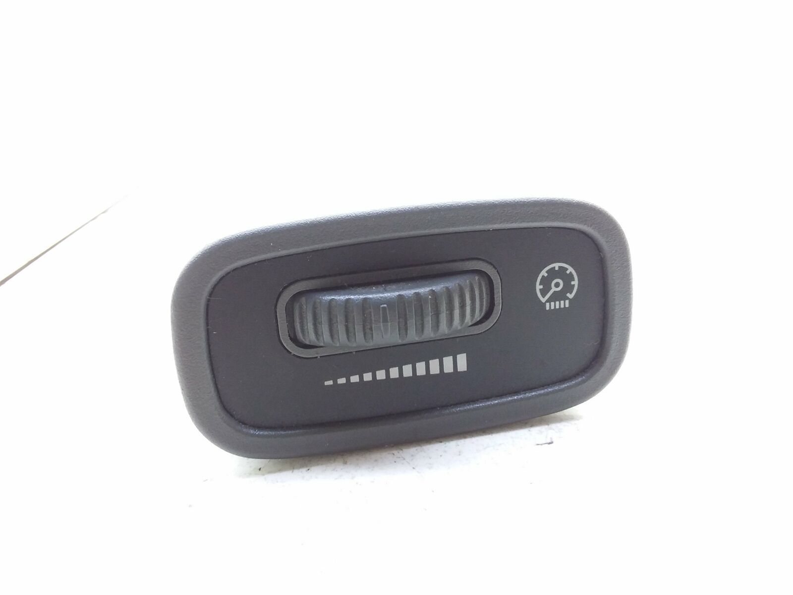

To the left of the steering column, you'll see a control dial for the instrument panel brightness. Make sure that is not turned down all the way. Here's an image shamelessly stolen from eBay:
At the wiring diagram, look at figure 09.2 for the dimmer controlled lighting. The dimmer switch is at the bottom left. Are all the other items on that page illuminating correctly?
