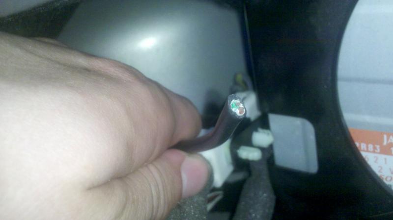

My car didn't come with a cd-changer equipped so I am looking to buy one so I can modify it for blue tooth capabilities. I am have a little trouble locating the cables for the unit. There are 4 unknown cables where the unit goes. One is the 3 prong power source, One has 10 pins (GRAY-Unknown), One has 15+ pins (Gray-Unknown), The last one doesn't have a connector because it was cut off ( IDK Why). The cut cable has 3 insulated wires running through it ( RED-Brown, Blue, Green ).

Here's The cut cable ( I think this is the cable that is connected to the one in the 1st picture ):
Is the cut cable the correct cable for the cd-changer?

Assuming the 03 and 04 is the same, there should be a small 4 pin-ish amp connector and a two port optical fiber connection to the cd changer. The larger connectors may be for the nav unit and the amplifier that goes in the trunk on top of the changer.
