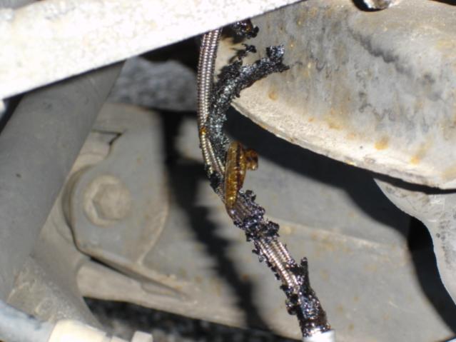

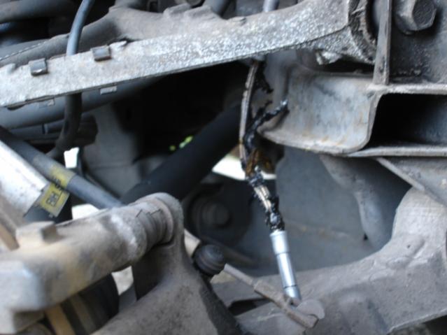

If you could, take a picture of the failed line and maybe that will spark something to me or someone else. I'm sure having the brakes fail on you is not a fun time trying to get a car stopped.

ok I've uploaded a couple of pics that i took a few minutes ago. The funny thing is, the first time this happened brake fluid leaked everywhere. this most recent time it happened there is no fluid lost, just an abs fault, and DSC not available messages on the dash. I double checked there is nothing touching the flex hose, only the two points where it is connected to the brake line and where it attaches to the caliper. Hope you guys can make sense of it. Thanks again for any suggestions.
