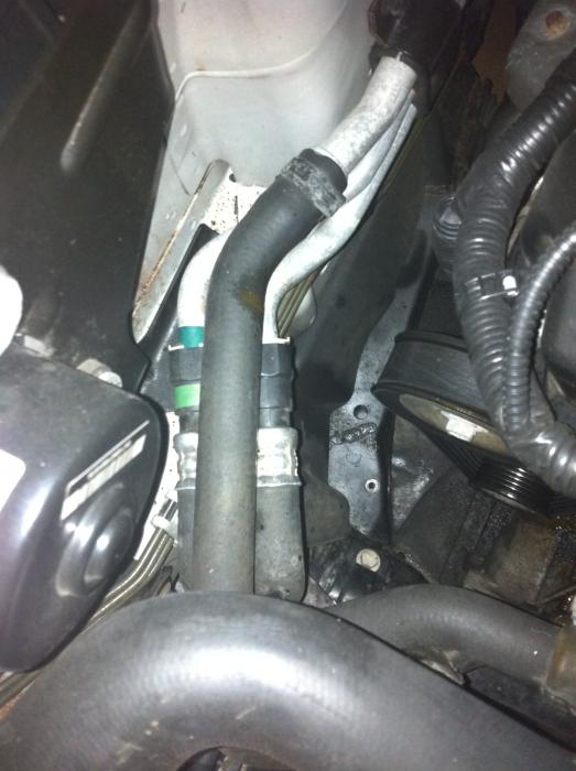

Are any of the hoses connecting to the DCCV likely to need replacing?
Are any of them easy to remove completely (so that replacement would be an option)?
Those "quick release" things... any photos?
BTW, you can see the DCCV partly from the RH wheel well if you move the liner bottom part out of the way. Not sure it's any use beyond that.
Mine's leaking, I hope externally as the weather's a bit cold to try to fix it currently.
Here you go...
The two quick disconnects are on the bottom two metal pipes going to the heater core. Mine is a 3.0 so there's probably more room, but you can see them. One is marked on both sides with a green stripe. make sure you don't confuse the two at the valve. otherwise the passenger and driver temp settings will be reversed.
Mine leaked externally and had no issues with heat. The moment you experience any sort of heating issues, change or at least electrically disconnect it, to protect the ccm.
