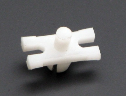

Default 1968-70 AMC AMX Javelin Door Quarter Trim Molding Clip
Not sure if these clips will work but for 0.75 US cents worth a try.
Let you know how I go.
They look remarkably similar!
1968-70 AMC AMX / Javelin Door/Quarter Trim Molding Clip
Attached Thumbnails 2005 aluminum window trim removal w/pics FAQ-img_8839-web.jpg
They look similar but with the protruding piece on top- you will need to cut that off- or you will never get the side pieces to fit where they should. The side pieces do not look like they are as thin as the Jag version, but that could be the photo. I would suggest just trying to slip one on the trim piece and see what you have before putting them in the body of the car.
Tom on Dallas/Plano
05 S-type 3.0 93k
The protruding pin in the center is the locking pin that spreads the feet of the clip to lock the clip to the door frame ! You just push the pin in till its flush , It is exactly the same to look at as the s type oem clip , but not a lot or even any cheeper to warrent the experiment . I payed about $120 nzd each jaguar oem ,

Now looking I can see a differance the footing clip is round and I'm sure the jag clip is square ! And from memory the jag door holes are square so I can't see this working .

Now looking I can see a difference the footing clip is round and I'm sure the jag clip is square ! And from memory the jag door holes are square so I can't see this working .
Yes you are right about the locking pin. Must be getting older. It may still work if the footing is big enough. Just have to try and find out. You could also use a lite epoxy to help and also the epoxy tape that Rick (joycesjag) talks about.
