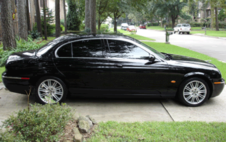

Yes I like my seat to go back so I can stretch my legs. I am only 5'11' , guess Jaguar does not
cater to tall people.
The car has black out tailights and very dark tint windows. Gives it a very cool look.
I cannot get it inspected untill I change ny tail lights and the tint.
Just bought the tail lights "one on e-bay for $50 and one from Jaquar $250" to get it
inspected. Think I will put the black ones back on after getting my inspection tag.
