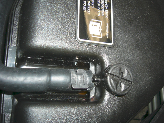

The program continues--the lh low beam headlamp wire was replaced so all the exterior lights,including DRL work.Pics of new wire attached.

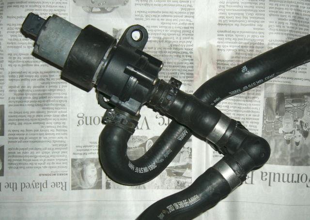

Plan is to replace coolant ,hoses,DCCV,auxiliary pump,plastic header tank,t/stat and possibly the T/stat housing.

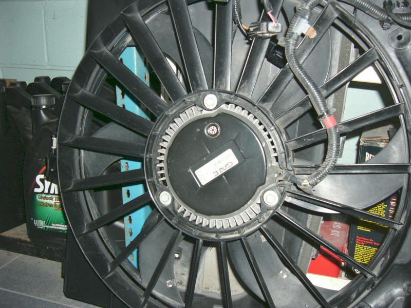

I have tested the cooling fan using my Mongoose/JLR SDD software/cheap laptop combo and was able to run the fan at all test speeds.

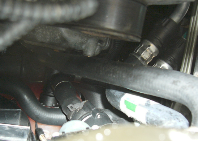

Well,I finally arrived home from Florida and have now completed the renewal of my cooling system.All went back OK and system filled with 50%Dexcool and distilled water.The engine has been run a number of times and it all works well.
I have taken a few pics.

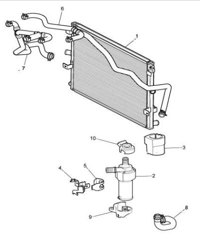

Here are the diagrams of from the JEPC.
First the AUX cooling pump on the 4.2 NA and SC. It's under the DCCV on the passenger side of the radiator. Hard to get to. Note #1 is the DCCV and several different heater hoses are shown. #2 is the AUX pump.
This is the SC coolant pump only on the STR. It's also on the passengerside of the radiator but lower and more towards the front of the car. Remove the belly pans including the one attached to the front bumper cover to get access to it.
Attached Thumbnails 2012/13 Winter Maintenance Program-Cooling System-aux-cooling-pump.jpg   2012/13 Winter Maintenance Program-Cooling System-super-charger-cooling.jpg

Thanks much. Mine would be the 2nd of the 2 diagrams presented. Maybe this weekend I'll pull her into the garage and see how simple or complex this operation might be. I ordered 2 pumps, the upgraded one from Eurotoys that woudln't be a direct fit, and a Bosch.
