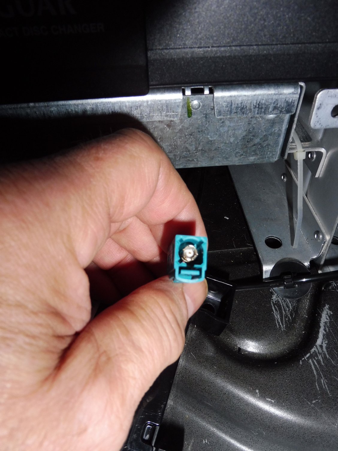

The bluetooth antenna conector is a FAKRA-C socket.
Mellow

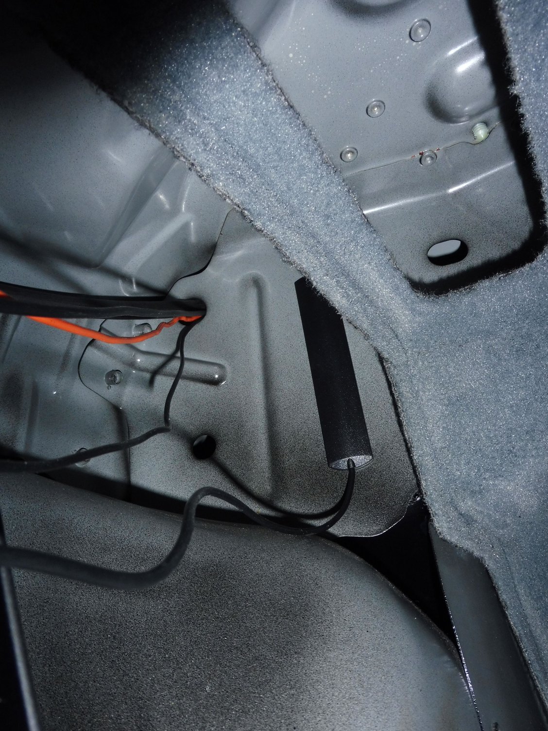

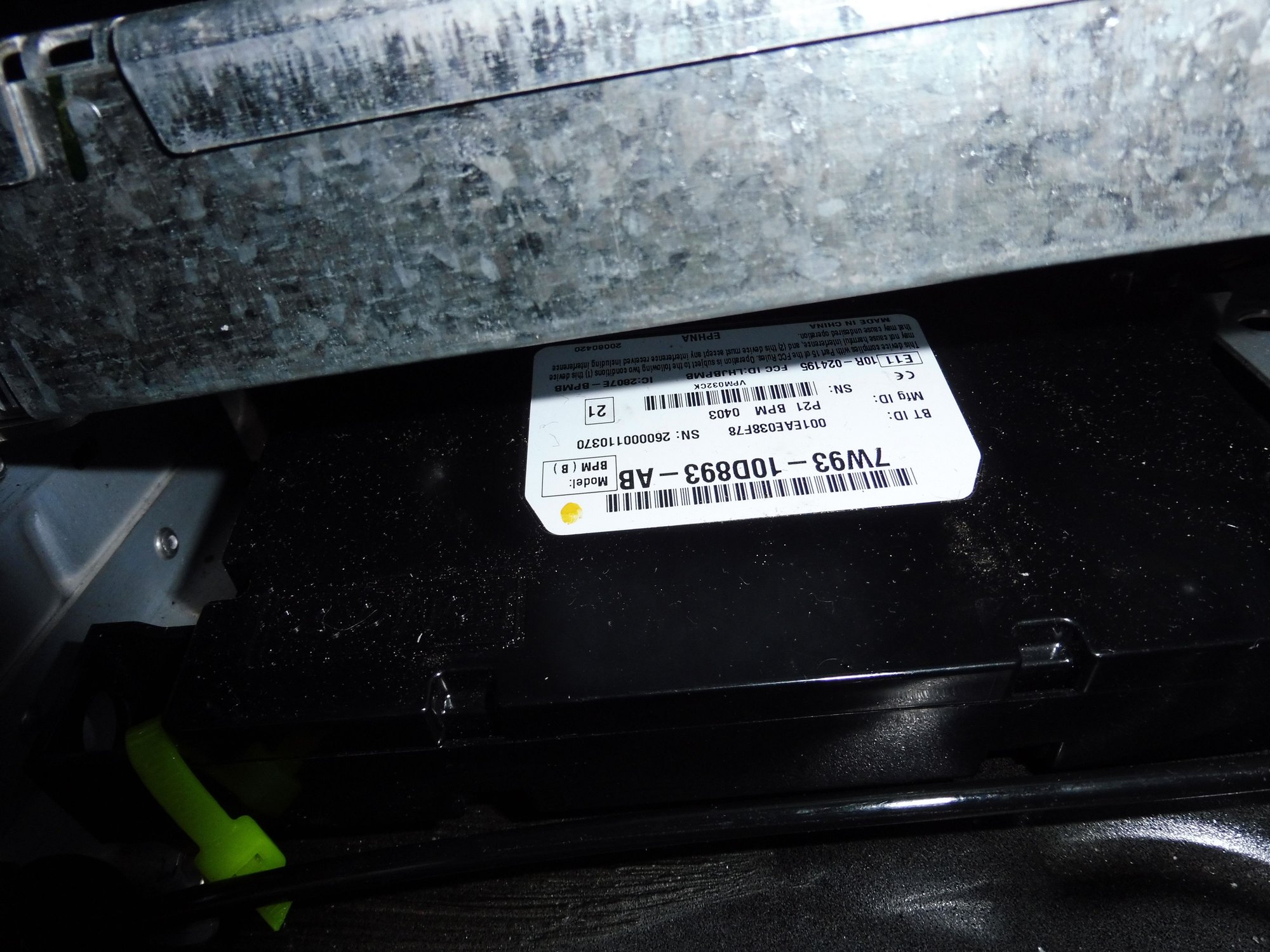

Default Pics of my Bluetooth module and antennae
7W93-10D893-AB Is the unit I installed in my 2005 XJR which is certainly not a MOST car. Works very well.
Also look at the antennae connection Looks identical to that Ebay one that I pointed out.

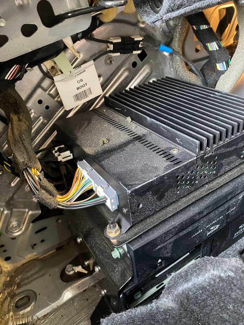

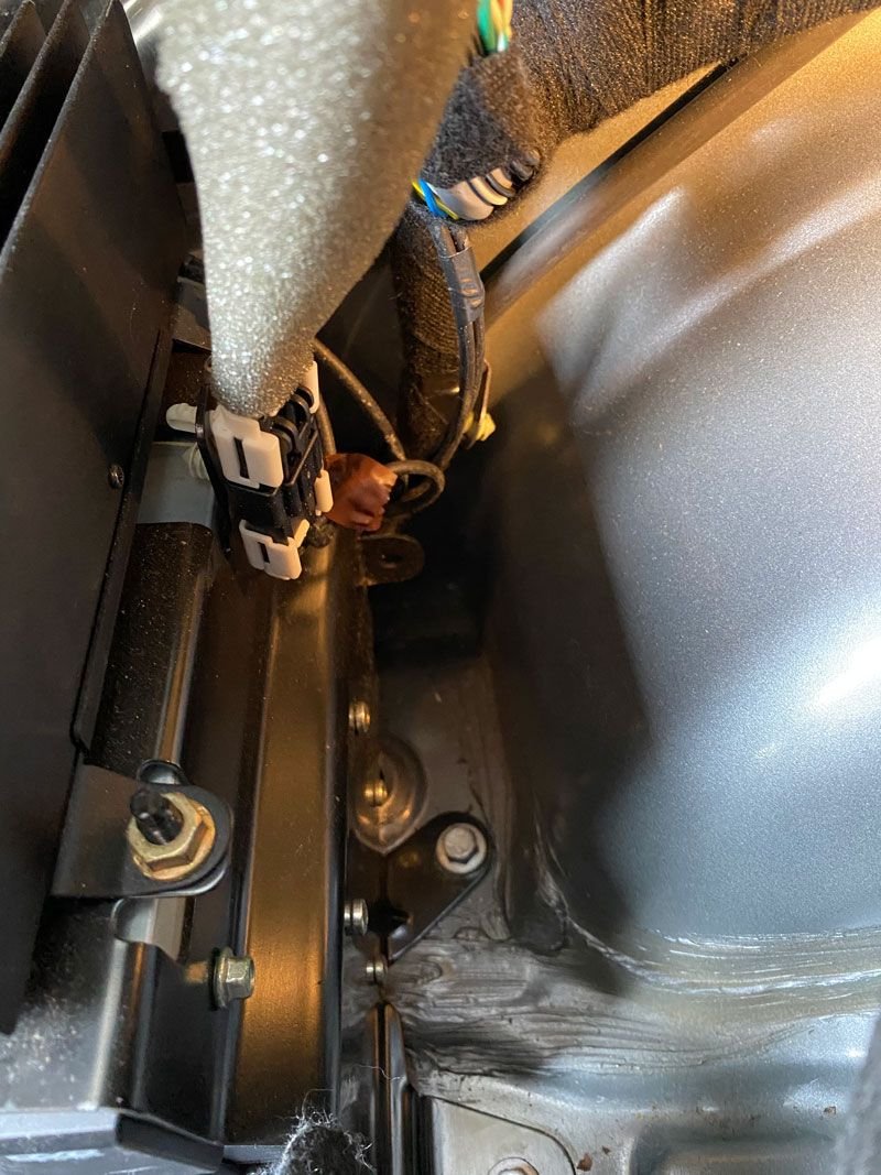

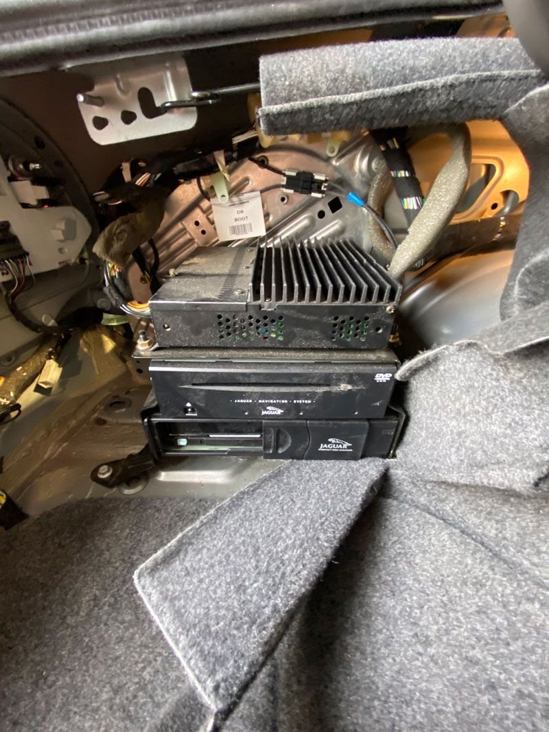

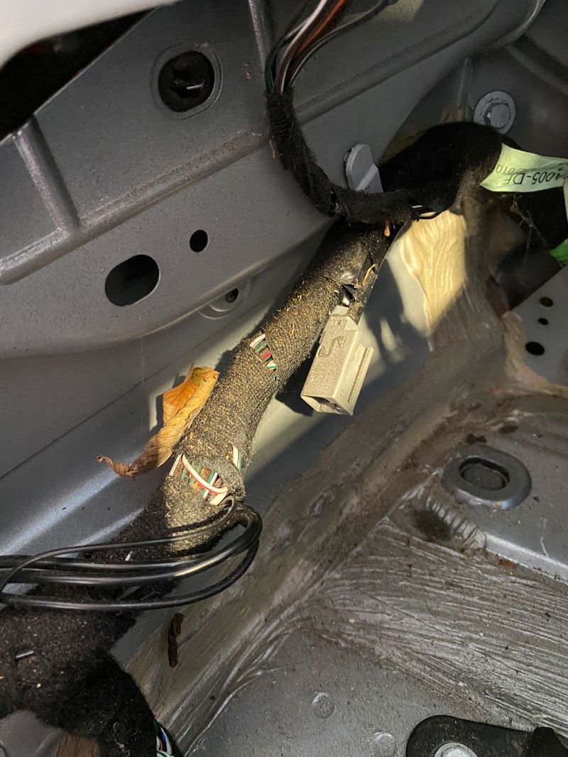

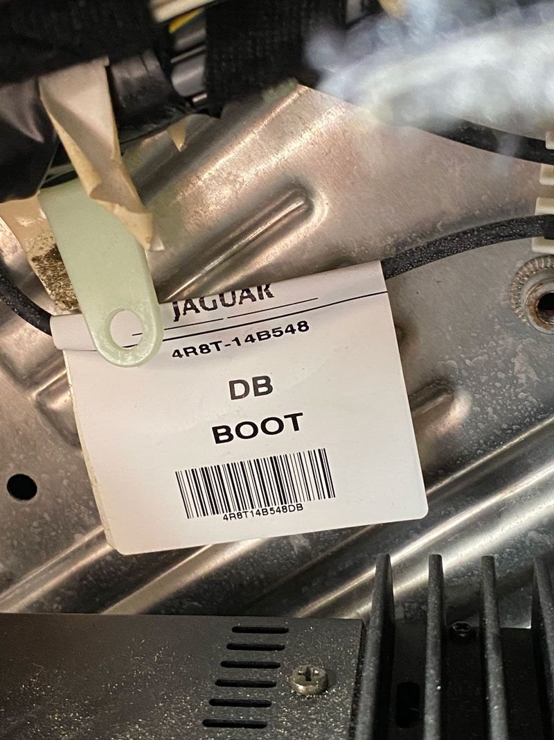

John, here are some quick photos I took behind the CD changer/nav stack. Does it look like I have DB2 and electrical connections? Should I unwrap some of the cables? Let me know.
Thanks!
