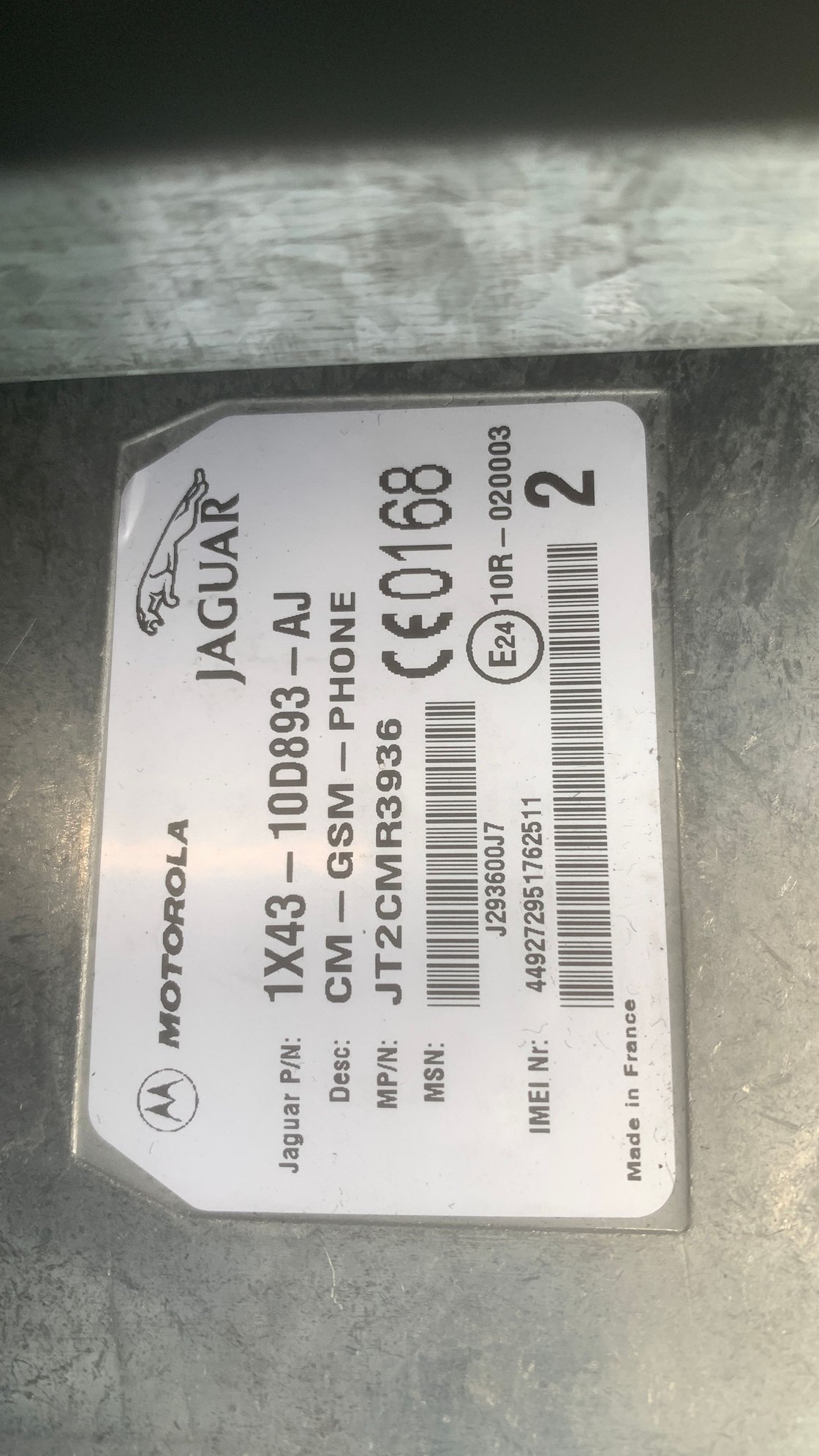

Hi,
I was trying to fix the phone not working on my secondhand x358.
so i already replaced the original BT module with another one (both AB type) but still nothing.
but reading this thread itfinally starts to make sense, it seems it will only work in combination with a voicecommand module, right?
i do have the voice button on steeringwheel and phone button on console but diag screen says i dont have it enabled.
one thing i cant find in this thread is: which model voicecommand module do i need to buy?
all i found was something called a C2C38921 module.
will this work?
thanks a bundle, been busy with this for months now.

You need to change the module in the boot for a later bluetooth module (2W93 part number) and then also install the BTUM module in the center consul in place of the wired phone.
The module you have in the boot is for the fixed wired phone only.
The bluetooth version was a modified motorolla wired phone module that requires the BTUM unit. It can only be paired with one phone, it has no signal reading on the touch screen and is not compatable with some newer phones.
The alternative is the 07 X-type and XJ6 bleutooth module and bluetooth antenna as mentioned in my posts above that is a newer Ford unit with a built in d2b interface.
This does not require the BTUM unit, up to five phones can be paired to it, you get a signal reading and it is compatable with all newer phones.
The downside is that it is not the same size and shape as the Motorolla module so requires a custom fixing in the boot.
As mentioned even with this later module you only get bluetooth phone access, no text messages, music or anything eles.
Mellow
