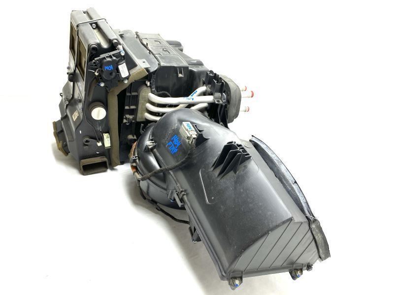

If you'd rather tear into it, the actuator for the dash face doors is on the upper right side of the heater/evaporator module in the dash. Looks like you remove the glove box for access on a LH drive car. See page 2696 in the manual:
http://www.jagrepair.com/images/Auto...M-Workshop.pdf
Here's an image, shamelessly stolen from eBay showing the location. This view would be from the right side of the car looking towards the center. The actuator is towards the upper left of the picture, with blue paint on it:
Don't quote me on this, but I think the Jaguar part number is XR857887. This is on the earlier model, but I think the number is the same for all years. The section for later years didn't show any details. See item #11:
https://parts.jaguarlandroverclassic.../brand/jaguar/
It's very likely this is actually a Ford part. I poked around with that number and some of the hits did show a Ford logo. If you remove your existing actuator, you may be able to find a Ford number and save a lot of money.

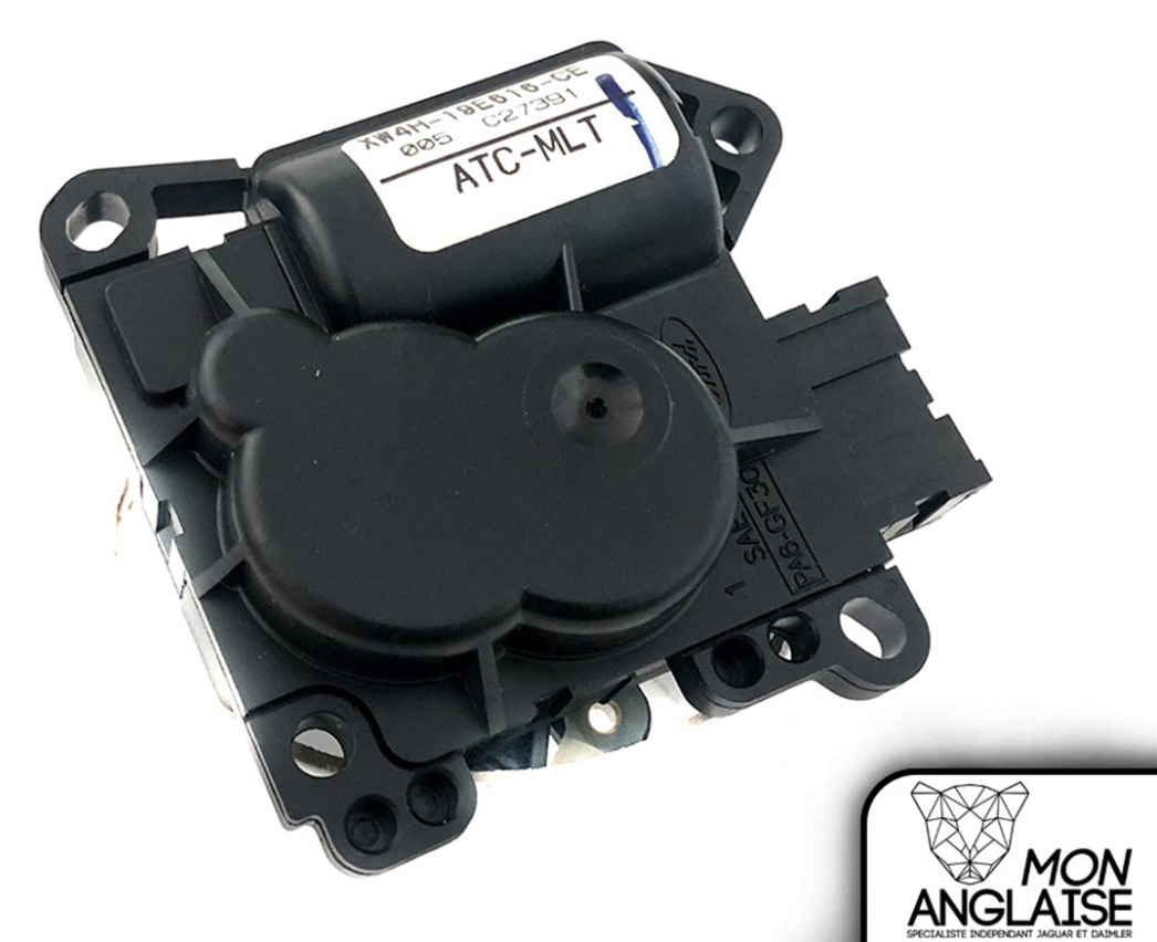

I did a little more digging. This link came up in a search for XR857887:
https://www.jagpieces.com/servomoteu...87-c2x26945505
The website is French, but note the Ford oval on the part. Also note the long Ford part number XW4H-19E616-CE on the white label:
The link also has several cross-references to other Ford part numbers:
YW4H-19E616-CA
YW4H-19E616-CB
XW4H-19E616-CE
YW4H19E616CA
YW4H19E616CB
XW4H19E616CE
No guarantee how accurate those numbers may be, but it should be worth investigating. Deciphering Ford part numbers can be a bit tricky. Sometimes they'll change a digit to denote a different vendor or color or minor stuff like that. Or you might find it has a different output arm and you'd need to swap it over. But in general, I've had good results searching via Ford part numbers. YMMV.
