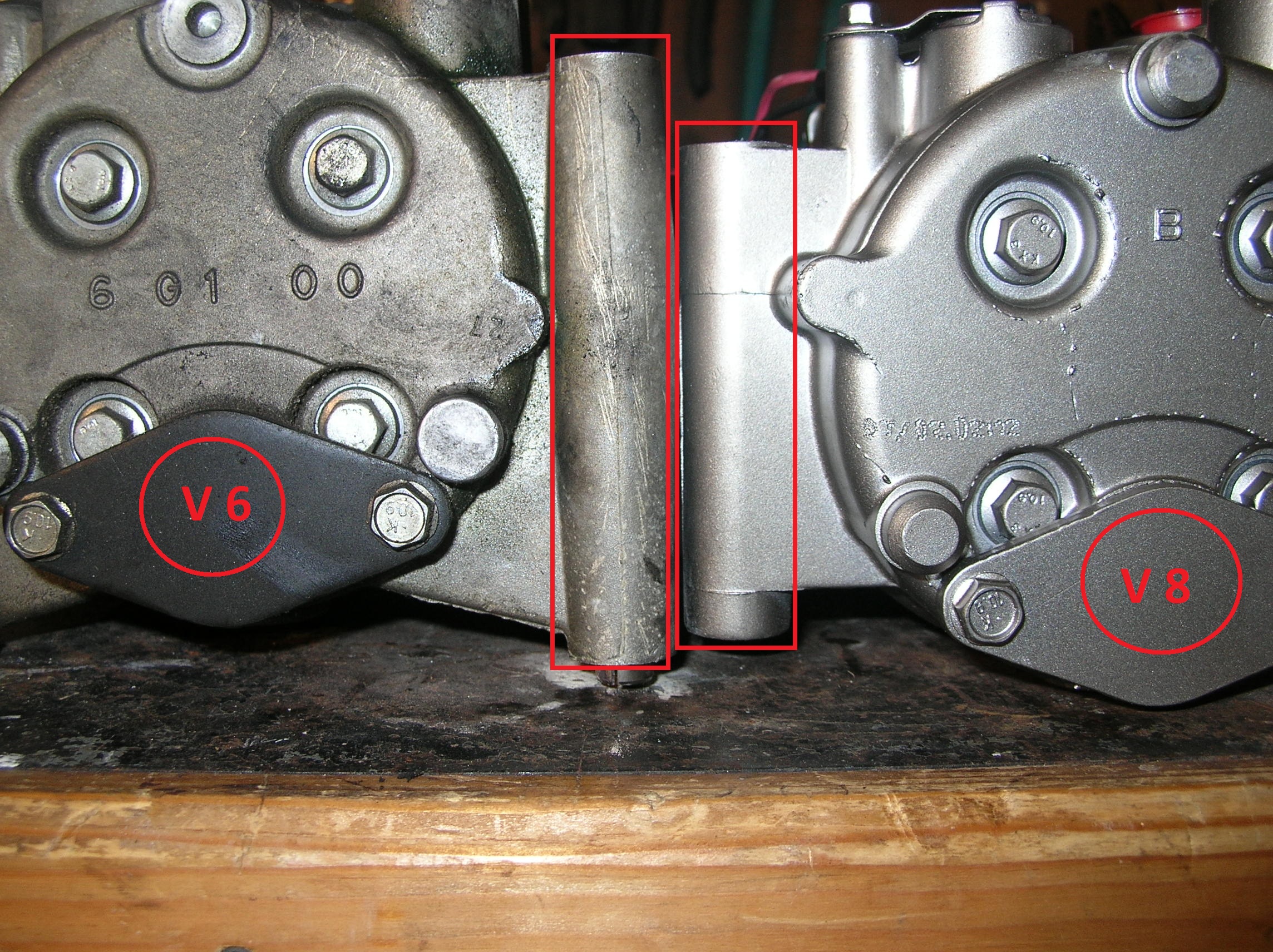

I know, but some years ago someone with a NA V8 had one of these compressors the piston cover on the back and he claimed that by following the TSB it fixed his problem. IIRC even Brutal chimed in and said he had came across a couple V8 that had the piston and cover.
Below is the difference between a V6 (pictured on left) and both the NA V8 and STR (pictured on right) compressors. Also notice the bolt guide lengths between the 2.
