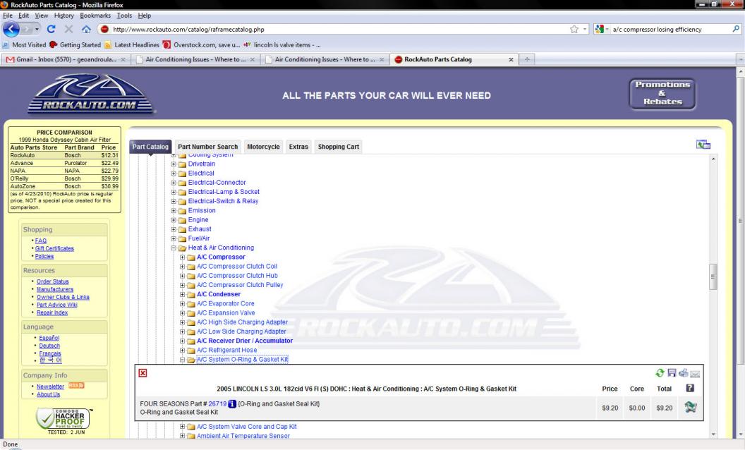

Anything other miscellaneous parts needed to replace the compressor and receiver/dryer? If not, I'm going to call the shop this afternoon, propose that I supply the necessary parts when I bring them the car, and offer to pay them for their labor and expertise. I don't expect them to be thrilled and won't be too surprised if they refuse....
Thanks George....
