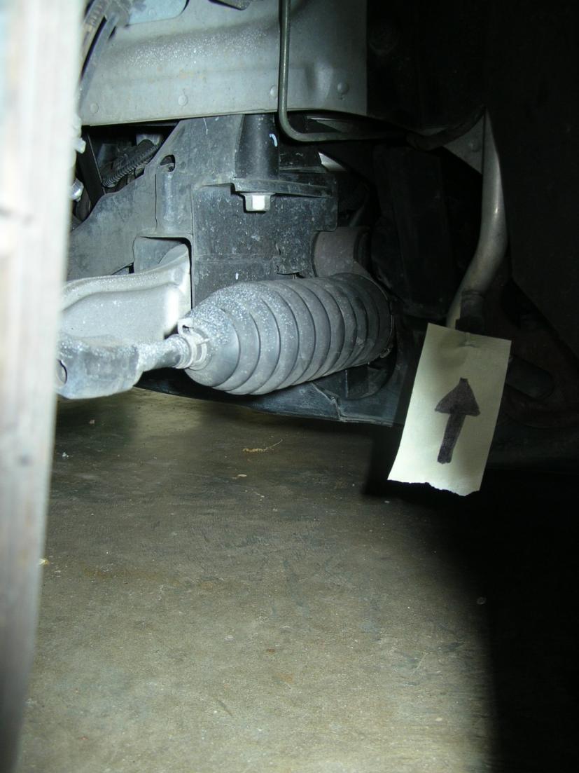

Jon while I was under Joyces the other day, I noticed greenish oil film on the lower part of the AC pump. Although the AC is still blowing cold, I presume I have a small leak. I am investigating. I agree with jagv8, you may need a top off.
Discount autoparts stores carry an AC gauge that connects to the low preasure nipple that is visible from being on all fours and looking behind the drivers front tire (US). FYI high preasure nipple location (under hood, drivers side near the top strut).

Rick, thanks for the additional input. Keep me posted on how your A/C situation turns out. Two questions:
1. By A/C pump, I assume you mean the compressor?
2. So to check the high-pressure side of the A/C, the undertray has to come off and the car has to go up on the hydraulic lift?
If that's accurate, what clown of an engineer designed that configuration? Never heard of such a ridiculous set-up for A/C on any vehicle I'm familiar with....

I stand corrected, if you get down on all 4's look into the rear of the drivers side wheel well and you will see the AC low preasure line with a black cap on it. No removal of anything.

I don't see that high-pressure A/C line or its black plastic cap when I'm down on all fours looking at the drivers side front wheel well. Is it behind the black plastic wheel well covers?

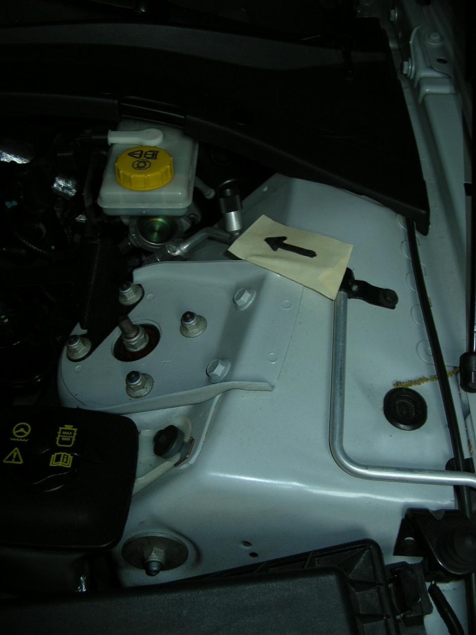

The tape is actually taped to the low preasure black cap. Last photo is under hood high preasure line.

Bingo! Thanks Rick, now I've spotted it on our car. Still, what a stupid location for an A/C valve. Not only difficult to access, but way down near the road exposed to flying debris and such....
That low-pressure A/C valve is cake. Shoulda put the high-pressure A/C valve in an easy-to-reach under-the-hood location as well. But no, that's too logical....
