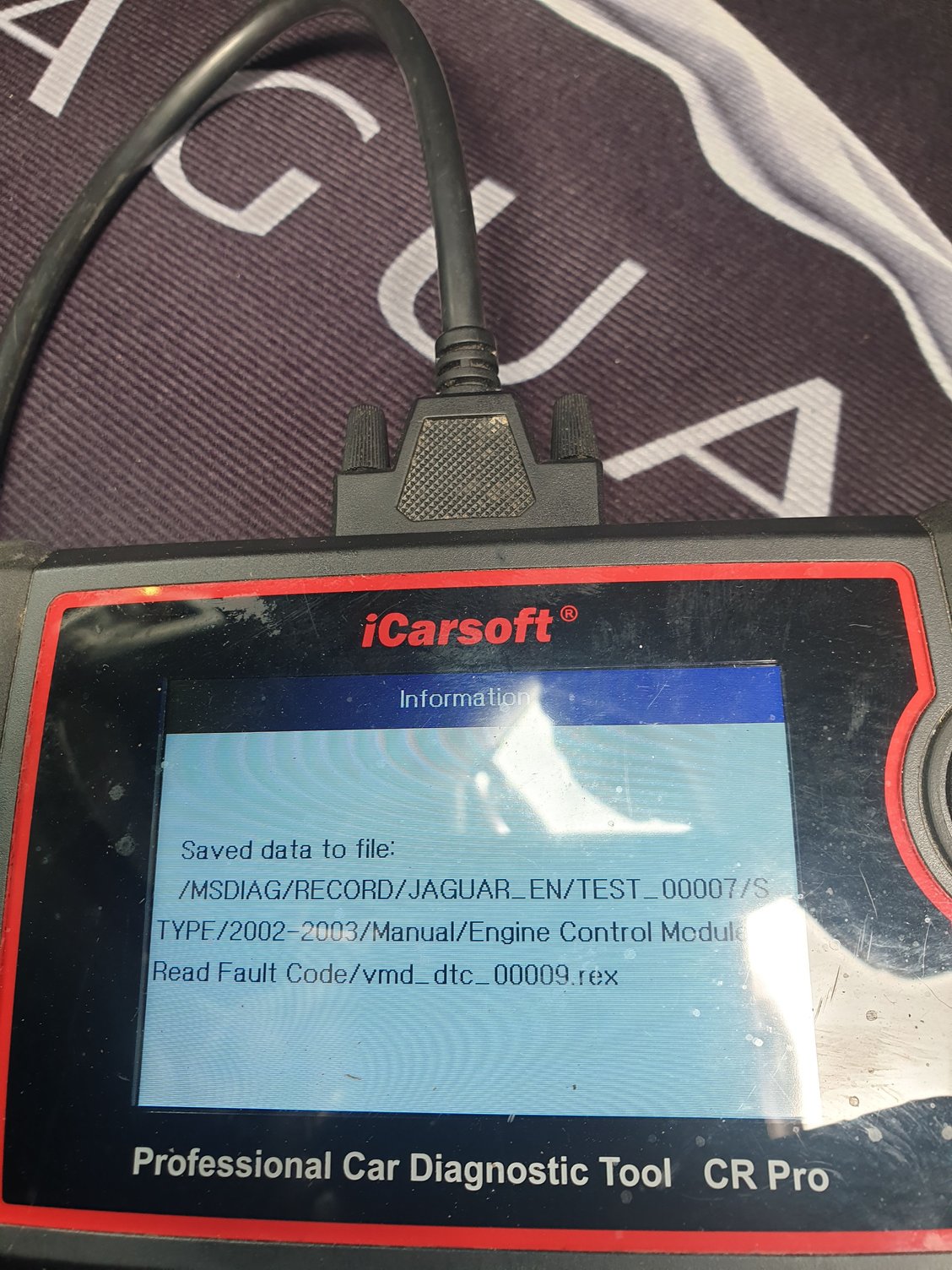

As some of you know I have to rebuild my s type 4.2 v8
after a lot of expense engine back together and in car
I now have a new fault code that i can not find any information on code B0300 network management explosion

Are you experiencing any problems relevant to this code?
I see precious little online for this code. It's a B series code for body systems such as HVAC, airbags, etc.
I note your last screenshot says 2002-2003, but your car is 2004. Maybe it's a scanner anomaly due to the year selected?
I vaguely remember something about some years having minor software bugs that would trigger essentially meaningless codes. Instead of updating the software, Jaguar's fix was a bulletin saying to ignore these codes. Ring a bell with anybody?
If you do find something for this code, make sure it's an official Jaguar document. Scanners typically give a generic definition, but some codes (usually non-emissions) have different definitions with different car manufacturers.

Something odd about the tool - network errors start U not B.
Do not trust it.
