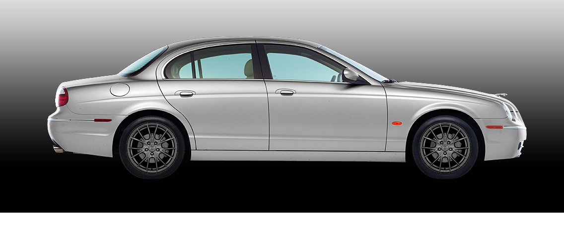

I have been at it again making changes to my 03 STR and am looking to change the look again. I have "limo tinted" all of my windows and "blacked out" the side markers and front and rear turn signals. I am now am thinking to replace the wheels and go with a matte black finish to match the theme. I like my current wheels (15 spoke Tucana) but the wheel doctor / wheel repair quotes I have received to powder coat my existing set is right around $800!
I found these on TireRack but dont know much about them. They ship with the hub rings, and new lug nuts complete for $650. I know with mounting and balancing I will be right around the $800 to powder coat my existing set, but I like the change in design.
Anyone have any experience with MSW wheels are they a good wheel, or should I keep looking? I know MSW is owned by OZ and is their lower end line.

Width's and offsets on those MSW wheels?
They 18 or 19?
Brembo clearance is a concern on your 03...

Yeah those Brembos take up a lot of room along with those 365mm rotors! here are the specs on the wheels according to our friends at TR.com they will clear, but I dont know thoughts...
Wheel Size: 18x8"
Offset: 45mm
Backspacing: 6.26"

That Wheel Is Half An Inch Narrower Than The Stock Str Front Wheel?!? I'd Stay Away!

Well luckily, the 8" wide wheel is pretty narrow, narrower than stock, particularly in the rear of an R. Some basic math suggests the rear wheel will clear the fenders fine, even giving you some extra wiggle room to add a spacer if brake clearance is an issue.
The front wheels, with 8" wide rim and ET45, it will poke out slightly closer to the fender over stock STR front wheel, by about 5-10mm. This should still clear the fenders, but if you end needing to add a spacer to clear the front brakes, it might be pushing it.

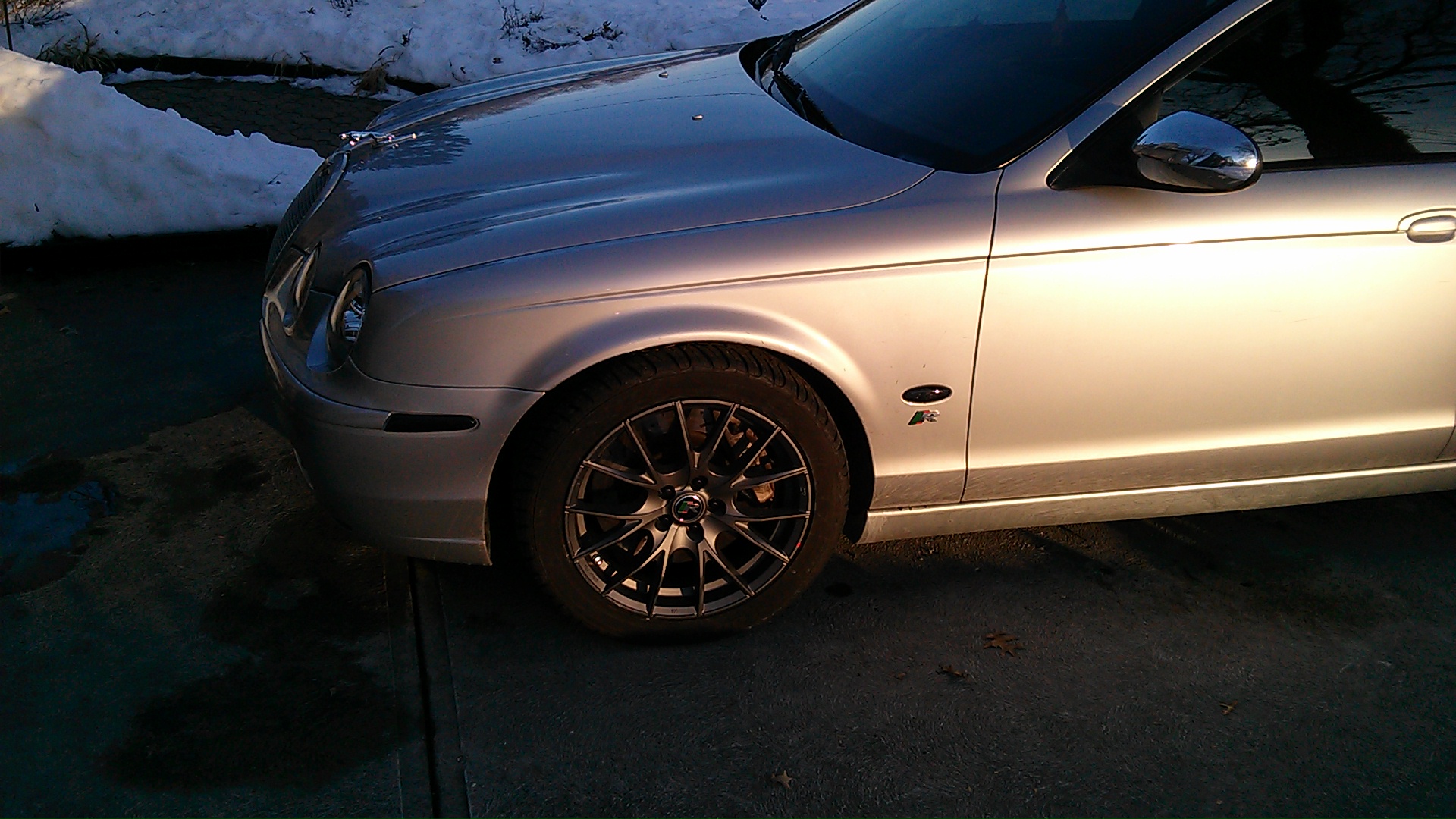

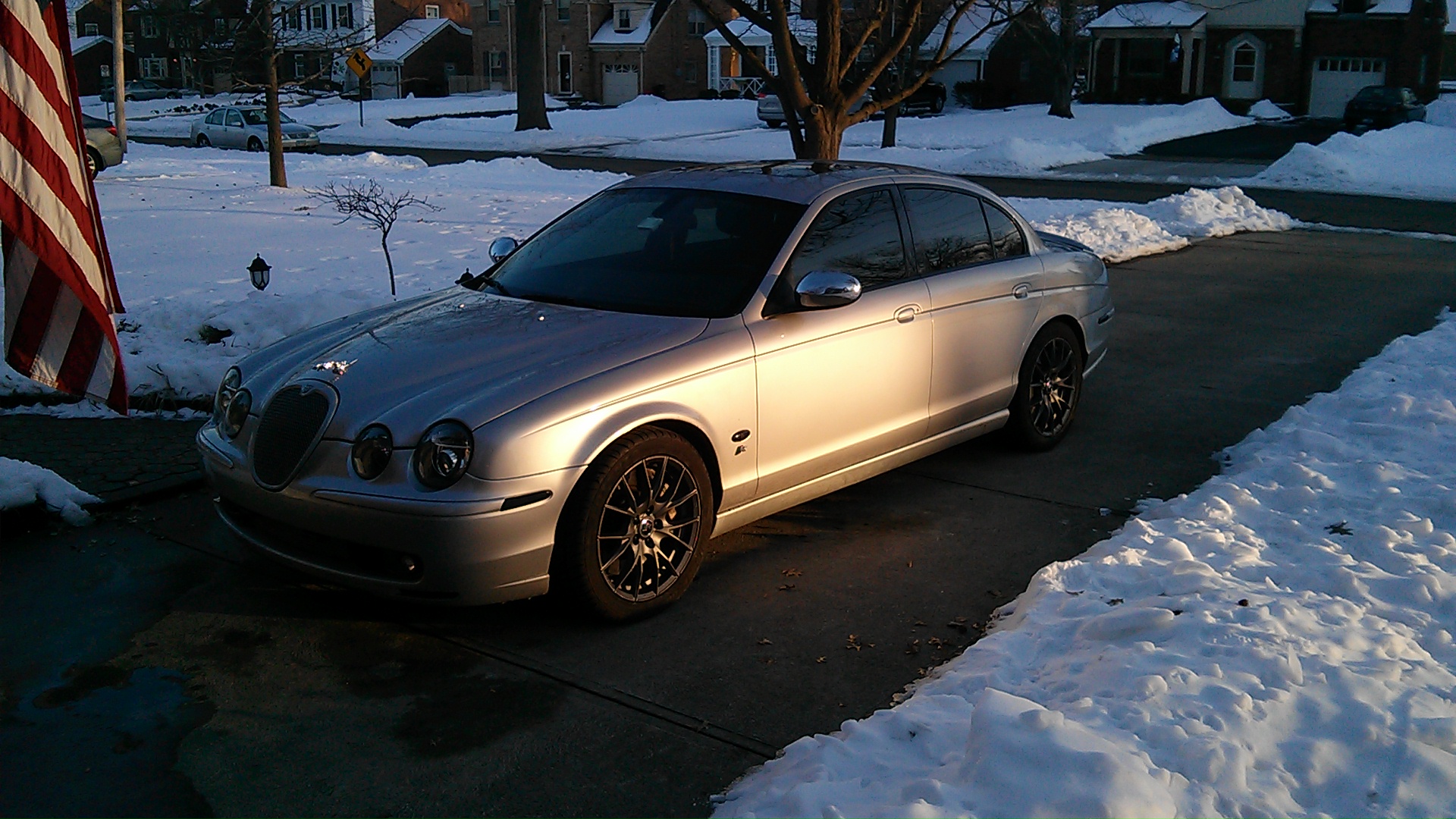

Finally the FSTKAT is home oil leak repaired and sporting her new wheels. There are many that I researched that do have clearance issues with the Brembo Calipers so be mindful of that if you are looking to replace your stock wheels.
I have not had a staggered fit for more than 7 years and have been running 18x8" wheels at all 4 corners with 245/45/18 tires. It works just fine for me and gives you plenty of wheel well clearance...
Here is a shot of the new wheels, I also replaced the center caps with the updated "R" logo to match the wing and boot badges...
