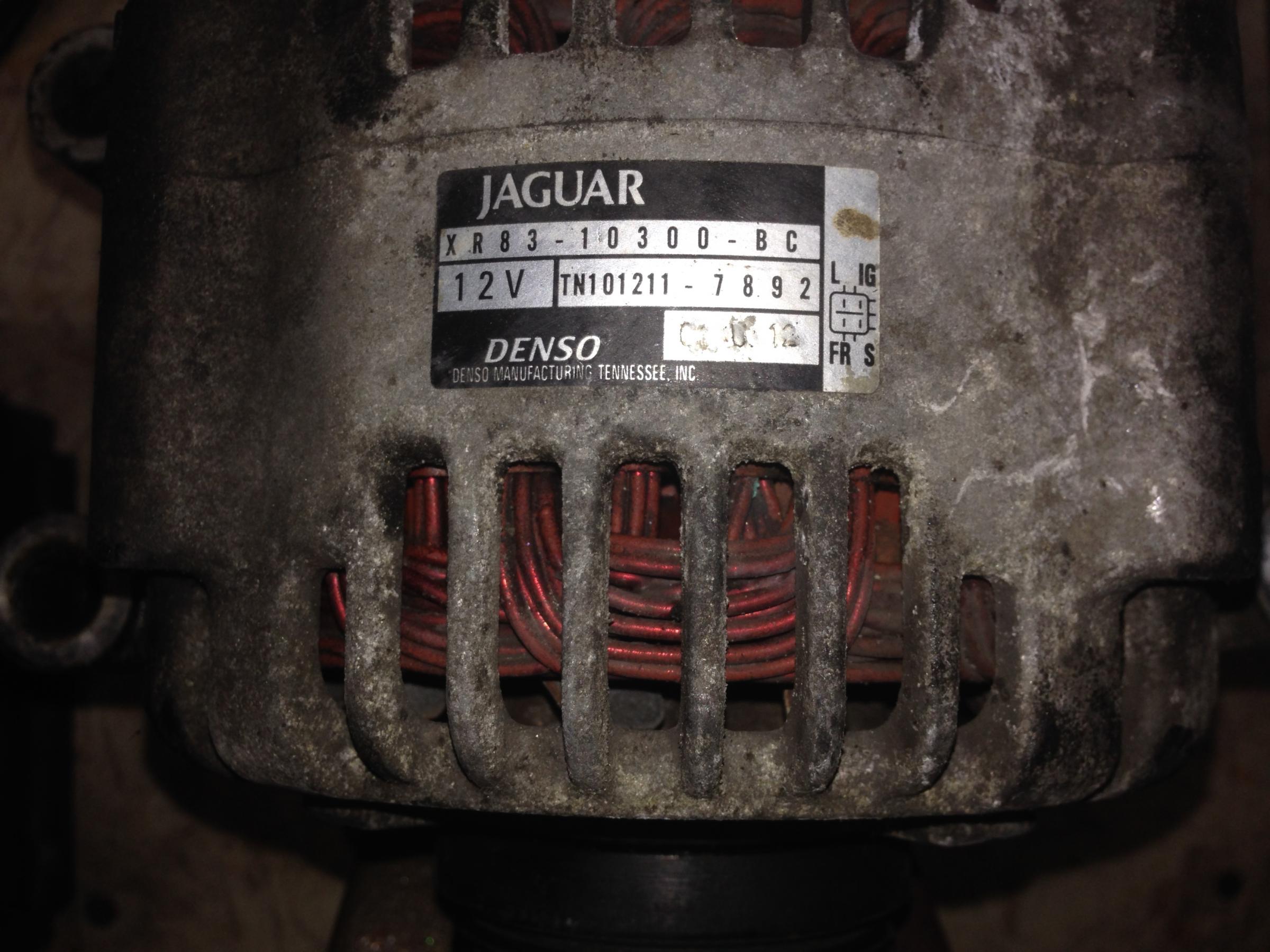

this is the alternator removed today, it has zero output, ordered a replacement. its covered in thick clay type oil inside and outside.
Attached Thumbnails Battery problems-photo-19-.jpg   Battery problems-photo.jpg

Sounds like you found the problem. Don't understand the petroleum coating - car have a prior leak that has since been repaired?

Ok, yes its odd that, there's no leaks around it, must have been repaired, odd thing the date stamp on the alternator is 2012, wonder if the guy brought a new alternator then swapped for the one I took off because he knew he was selling the car for a low price, let you know if its working when the replacement arrives. thanks again.

New Alternator fitted, now charging as it should, thanks every one, onto next problem now, a slight misfire on tic over, had new plugs fitted so could this be a coil pack?
