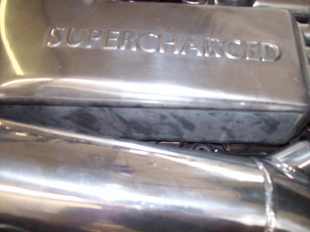

The nice thing about the chiller is once it is installed just leave the climate control on & you have nothing to worry about refilling. I love the way it works.

I am guessing you just get the cheapest kit KC makes since they make none for the Jag. And your saying in your setup you seperated the stock cooling system. Added a new res and pump and then used the stock pump also? I can't picture it without a diagram. I understand the diagram Vance posted.
I am very interested in this. I may do this mod right after the intake elbow to get it nice and cool prior to the pulley swap.
I appreciate your breaking it down for us.

After reading it a third time I may have it. One pump to run through the fac core and another to run through the KC core to make up for the pressure drop of adding the second core to the system? Why the second resv at the chiller unit?

The resevoir between the charge coolers & the chiller is to increase the volume in the cooling system.
