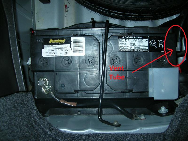

With regard to the battery vent, what should I be looking for? I've seen vented caps, but never a vent. I understand that it needs to vent the battery gases outside, so should I be looking for a small hose of some sort? I haven't pulled the original battery yet, so I'm not sure what to look for. With regard to potentially trickle charging it in the future (I don't drive it much), are there any cautions I should be aware of? I remember hearing about some warnings on where to and not to hook up charging leads on other cars. I don't want to fry out anything. Running the battery down without starting it has already filled my idiot quota for the month - I don't want to pull a second knucklehead move.

on my car the vent hose (about the thickness of a straw) connects to a (nipple) on the side end of the battary near the + tremanal and goes out the boot (trunk) somewhere behind the bumper.

Look at this thread, post # 15 specifically, in that post there are pictures of the battery you are looking for. Top right corner of the battery pictures show a white 90 degree elbow coming out of the battery and connects to the black vent tube.
https://www.jaguarforums.com/forum/s...e-stuck-32699/

Heres a better shot:
Attached Thumbnails Battery went south-autozone-duralast-gold-001-vent-tube.jpg

The vented batteries are supposed to come with the vent nipple attached to the battery somewhere. They sometimes get lost. So, even if the part number is correct, examine the battery to make sure it is still there. It is that little white nipple in the picture above and will not be pre-installed.
BTW, in addition to the primary reason of avoiding explosions, the other reason for venting to the exterior is that the gases are corrosive.
