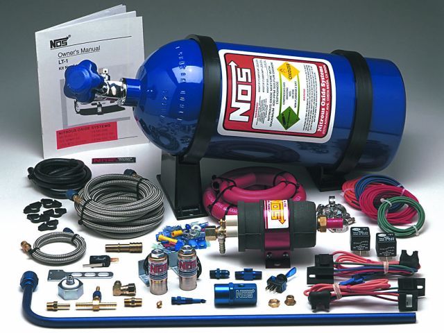

Maybe not internal but.......
Attached Thumbnails Best internal performance mods for 4.2L S/C-nitrous-oxide-system-lrg.jpg

Lol. Rick, originally took your nitrous as a joke, but this faded and became a possibility. Mcjaguar's, the heads are already excellent in flow and dynamics. Save the mod money for the soon to be released avos twin screw kit that alone equates to 150-200 chp. Or do what I did for an est. 60 chp gain.
