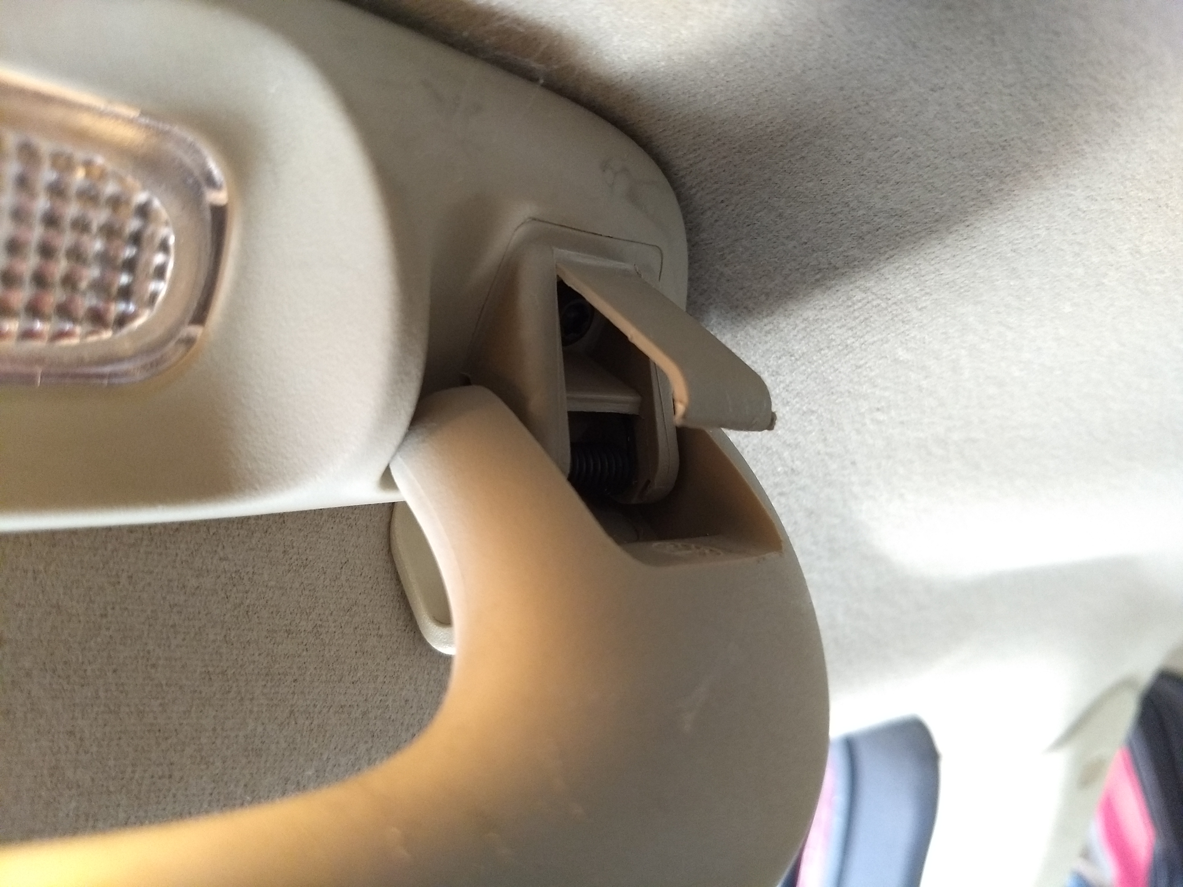

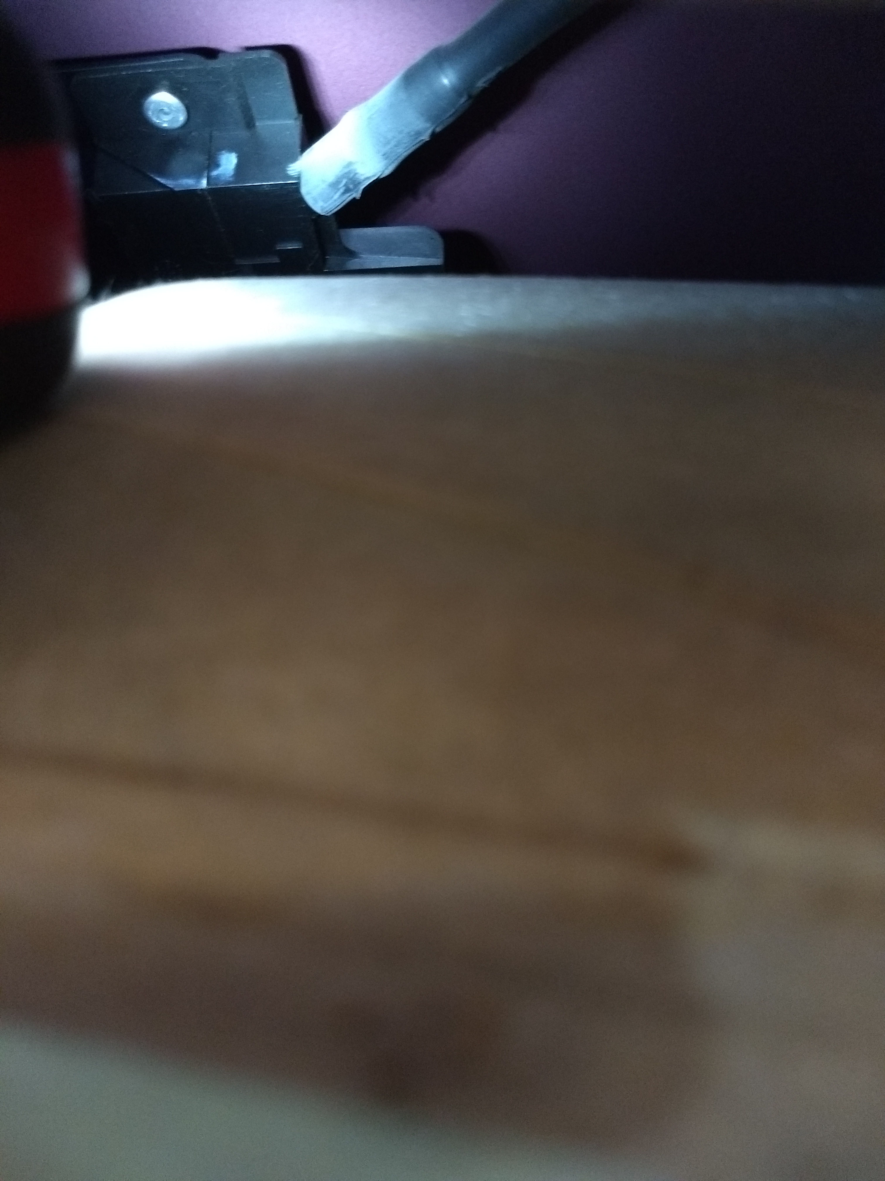

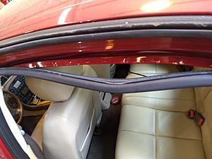

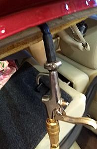

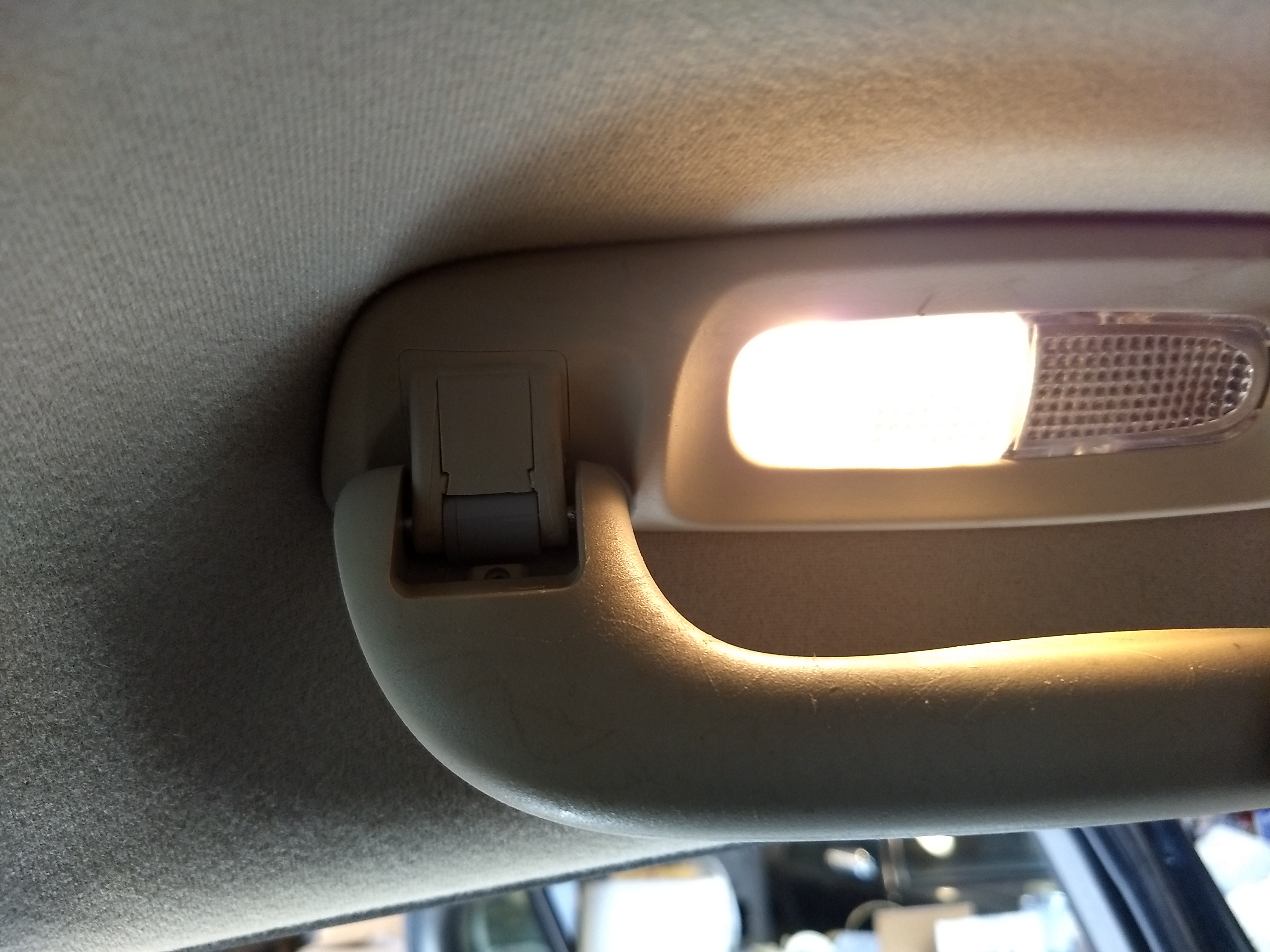

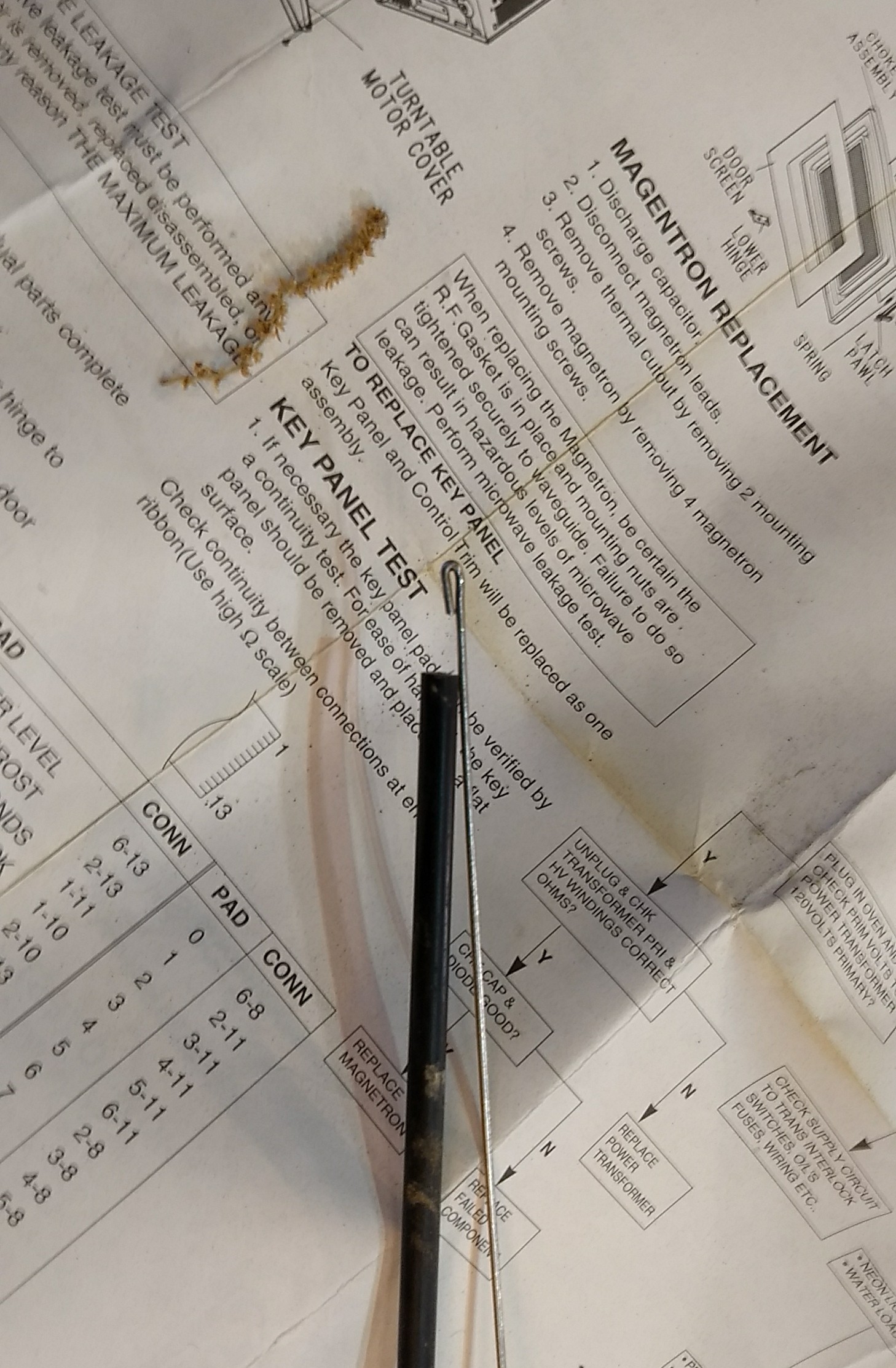

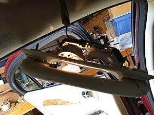

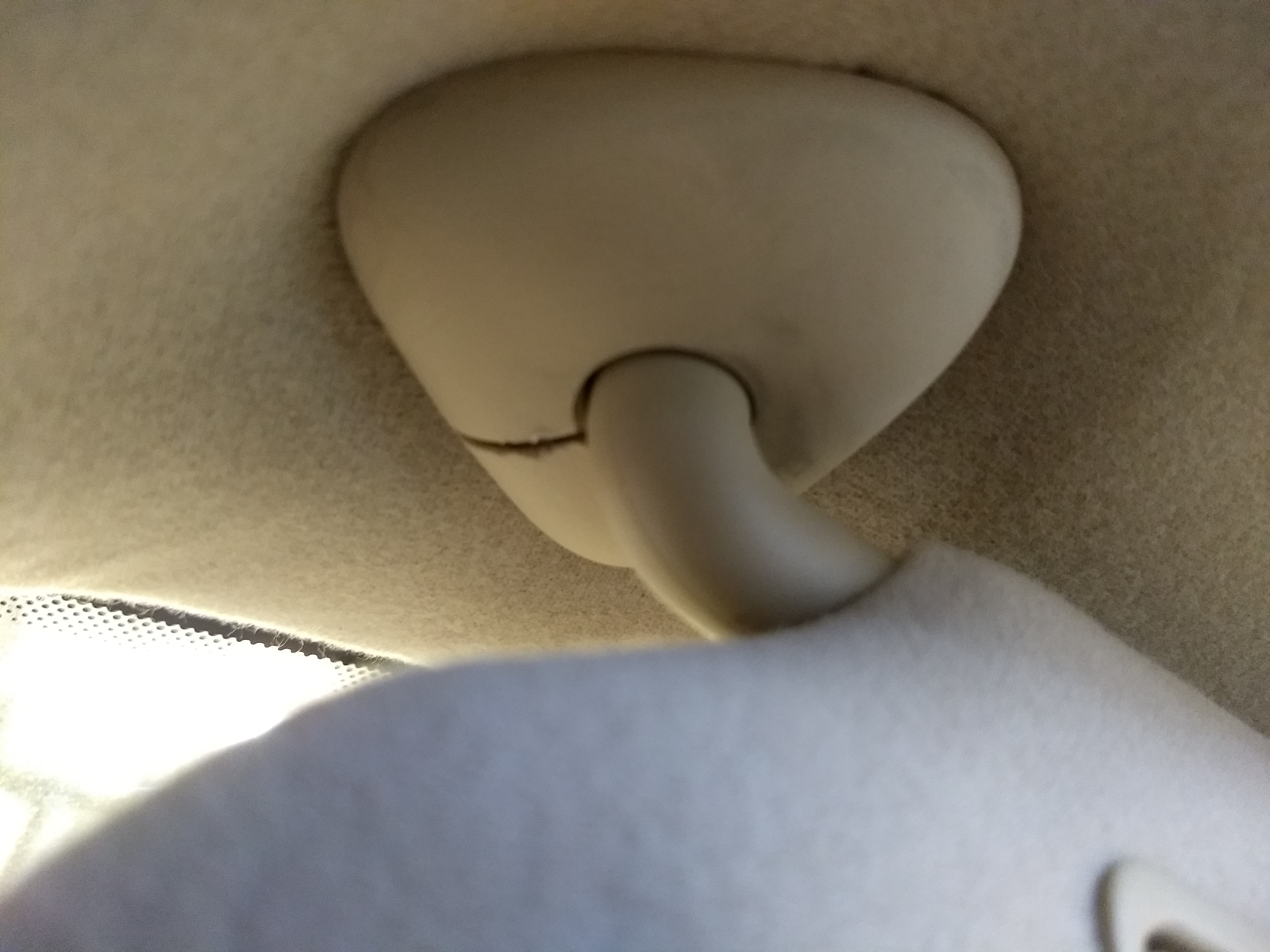

First time for me, yesterday on the 05. Strangely enough, the 03 hasn't needed it yet, it appears, although the 03 parts-car could do with a drain-cleaning. I started on the left side, then did the right, front-to-back, both sides, didn't encounter an issue until the last one in the right rear. Absolute clog. 100 psi air hose and all I got for my trouble was a face-full of blowback! My first thought was to grab a handy small worm-gear clamp from the pegboard and clamp the hose to the air nozzle and have another go. Turns out my tiny worm gear clamps weren't quite so handy. I know i have some....somewhere!
I had some control-cables of unknown origin...I believe I obtained them in a box of quite useful stuff a friend gave me when his wife was "cleaning" his garage..."helping" him by throwing out a bunch of useful stuff. Anyway, I actually COULD find those, even so I've no notion of their origin nor foresee any particular use for them. Not thinking far enough ahead that housing and all were small enough to run down the hose, I cut the crimped end off the wire to extract it from housing, re-bent it to prevent poking a hole in the hose and ran that in its full length a few times. Re-tried the air hose - no joy.
Tried the control wire housing - similar result.
Then it dawned on me: Spruce Bruce (long-term down X300) in the adjacent bay was just bristling with the sort of worm-gear clamps I needed. I removed one, cinched it down tight around the hose and air nozzle, pulled the trigger....and....POP!!! then the free flow of air exiting somewhere 'round the lower rear of the car.
I then recruited my 16 yr old daughter to attend to the air trigger while I searched out the exit point. My concern was that I'd blown a hole in the hose somewhere in the boot.
Never found the exit, per-se - the other end of that hose is well-concealed. I did find a length of the hose routed through a bulkhead in the boot, passing outboard into the fenderwell and pinched it off with my fingers to confirm there were no leaks upstream of that point. Finally, I removed the air nozzle and fit a funnel and poured water in the hose. It came dripping off the muffler and formed a puddle under the right rear, aft of the right rear tire. I called it good. Here are some random pics in case they be of help to someone.
Needs a headliner.....maybe this spring/summer when everything else is brought into fine nick...
