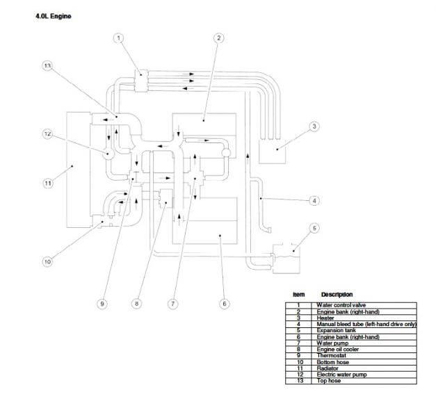

I also like Thermostat as the culprit. However the schematic shows a Water Control Valve (item 1) and an Electric Pump (item 12) in the system:
Both of these are troublesome on other models and worth investigating.
