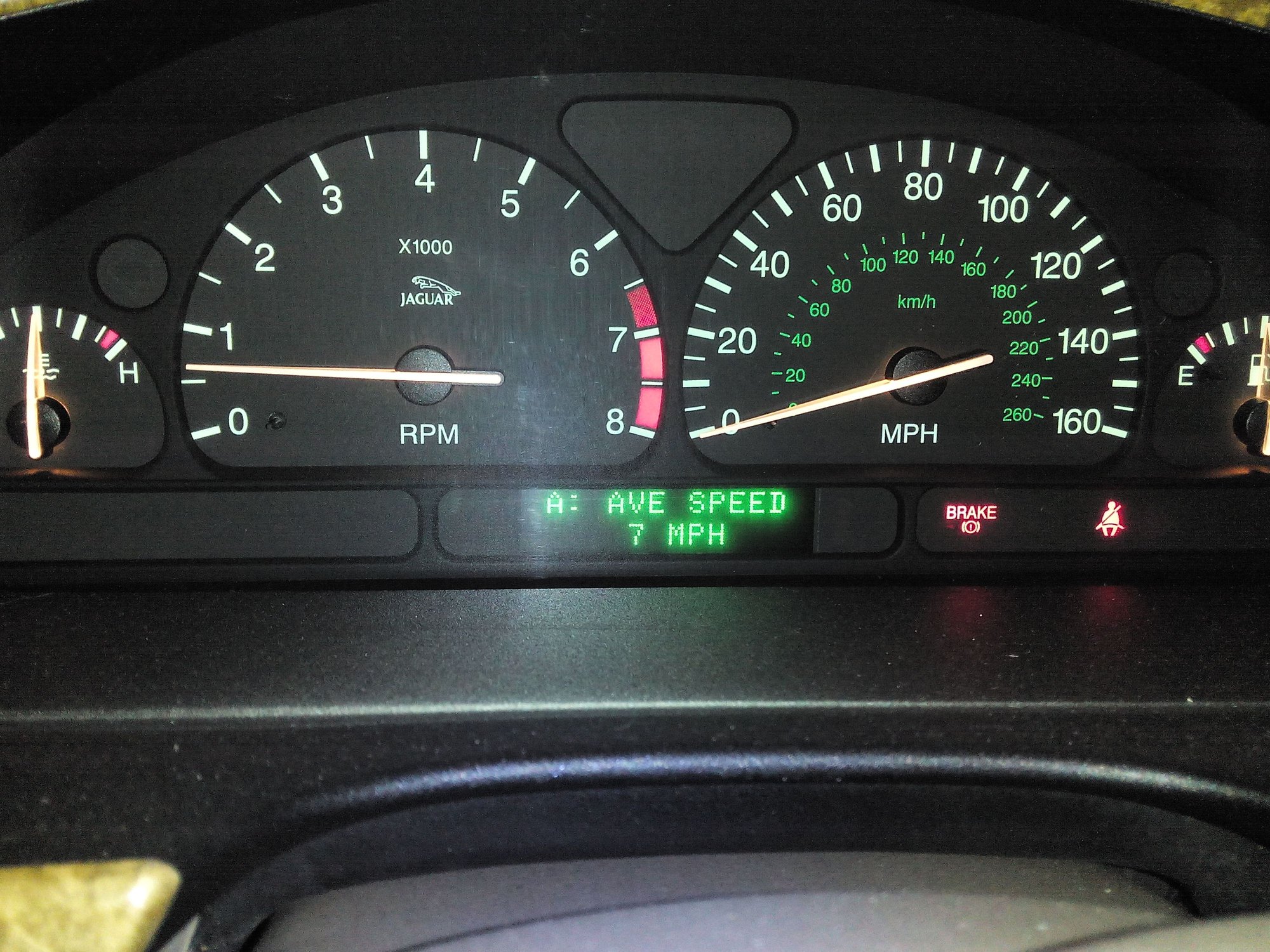

I had a flick through the trip meter on the dash while driving about and came across my average speed reading.
I thought "that's going to change shortly", but strangely enough, it didn't.
And the only time I got down to this reported speed was at junctions or traffic islands.
Now it's got me thinking that maybe my lack of power could be associated with a wheel speed sensor problem thats not showing up because my OBD reader won't read 'C' coded faults. Which is what a speed sensor would show up as, if I recall correctly.
Took this photo when I got back home

I would try not to drive it at all until you get these vital sensors working because it will fuel very badly and may destroy the cats.

The erratic ECTS signal - Shouldn't that also be driving the dash gauge all over the place? Or are you just seeing quick spikes on your scanner? I realize the gauge is deliberately dumbed down, so maybe quick excursions don't register.
The inaccurate AVG speed - A little more research may be in order. My hunch is that figure is based on transmission output speed, not wheel speed. The transmission output speed is already fed to the ECM for its calculations. Wheel speed primarily goes to the antiskid system. The two systems probably crosstalk to some extent, but I bet each computer is biased towards its own respective inputs. Strictly conjecture on my part, so take it with a giant grain of salt...

As for the average speed read-out, been looking around today on the net and haven't found anything significant at all.
From what I've read so far, and not currently being able to read any 'C' codes, the ony thing that may indicate a wheel sensor problem is if the traction control flagged a fault, but I've nothing in that department.
