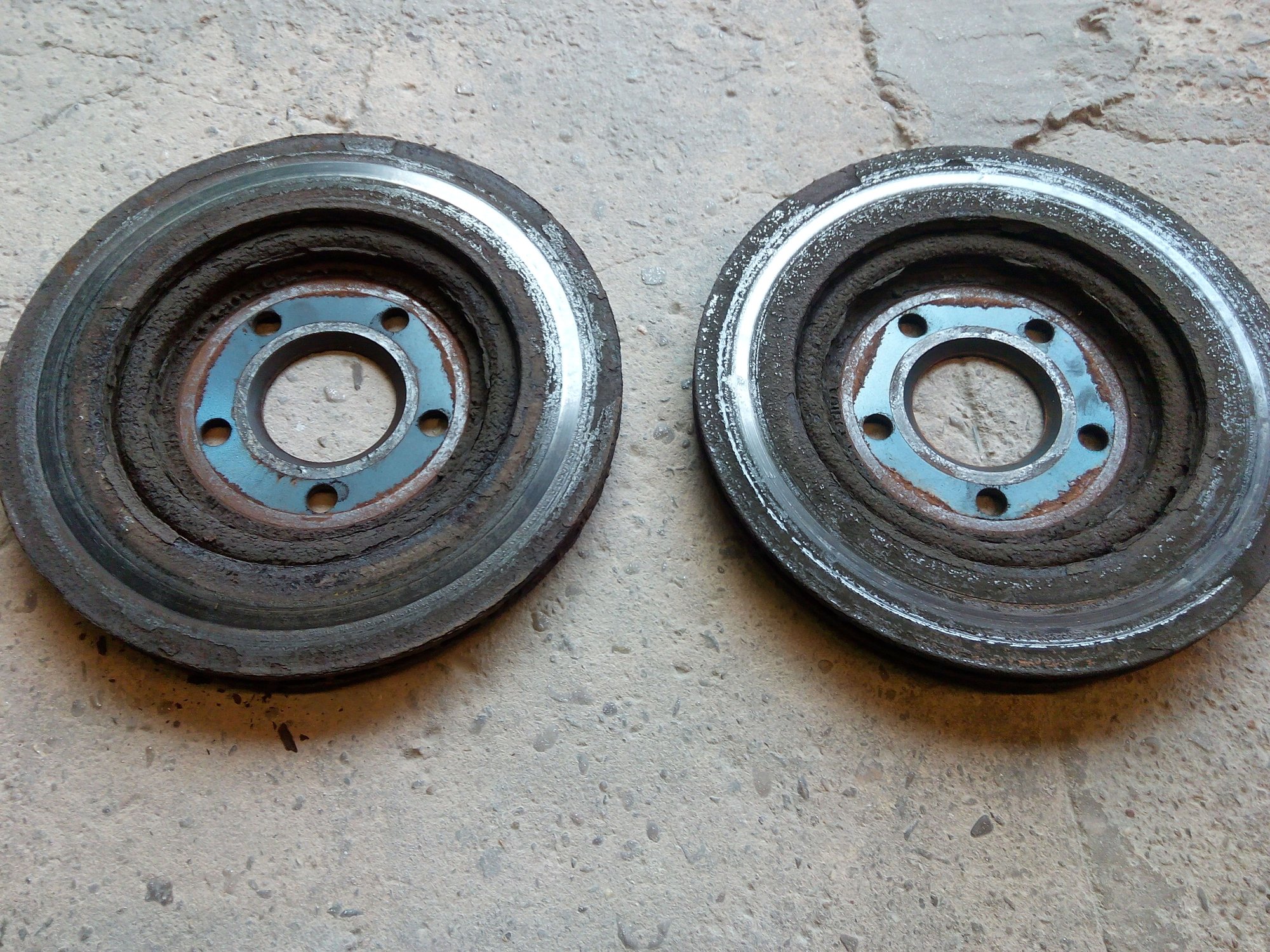

Finally got round to replacing the rear discs and pads today.
Only been meaning to do it since I got the car.
I reckon these would be good for a few more years yet though.........NOT!
And I discovered I need a new tyre as well,,,,,,,,,,,,,hmpf..............damn thing looks like the braiding has buckled inside the carcass.

MOT failure for sure! I haven't seen discs that bad in some time.
Forgive me if you've answered this already, but do the rear calipers work?

The calipers work as they should thank god.
I had an assistant push the pedal while they were off and you could see the piston move very easily. They wound back easy as well.
All the slider pins were gummed up good and proper, barely moving against the caliper pressure, so there was the main problem.
I don't think the previous owner had the any mechanical knowledge, or at least very little, to cope with a car like this, as he used to put it into an independant for everything, so I think it was more financial restraints that got it into this state, hence why I got it for so little money (£480).
Luckily I can do all the work this car needed.
And I love the trade prices from my suppliers, the new discs and pads only cost me £36.95.
I've fitted Apec discs and pads. Mainly because in my old unit I was an Apec Approved supply and fit centre so I know the product already.

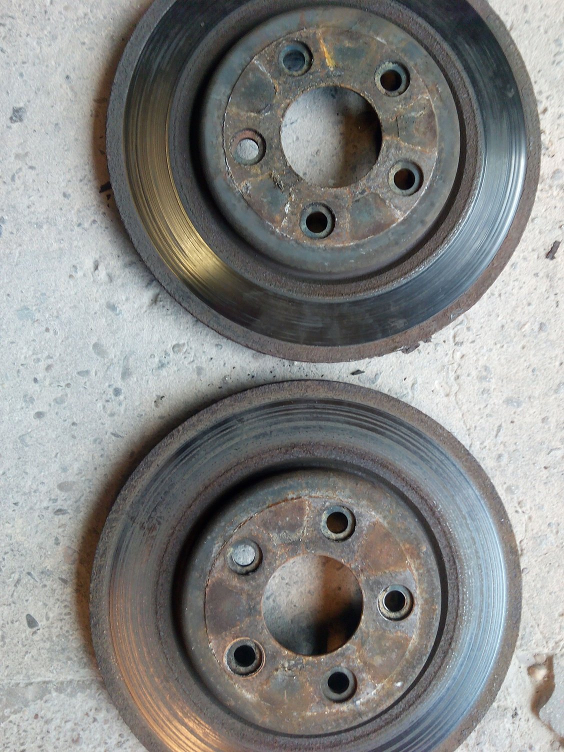

Your discs look cream crackered !!!

And hell yes those discs are shot to high heaven. Just goes to show how the previous owner did his maintenance.
