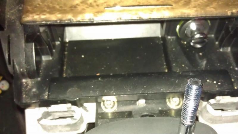

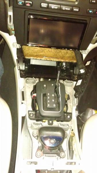

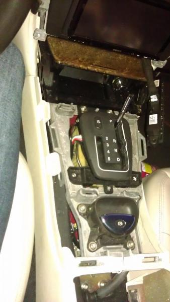

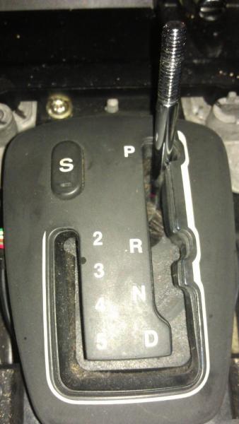

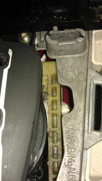

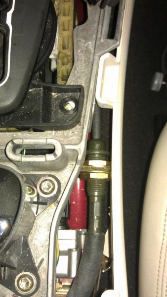

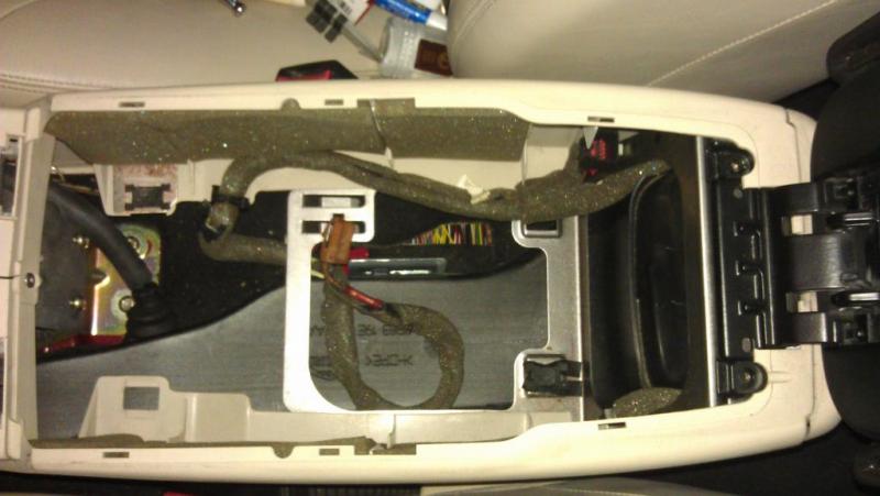

I'm trying to shift my car out of park but when I step on the break I can't hear the shiftier disengage anymore. I at one point saw a tiny little bit of smoke come up from the shiftier. I have taken most of the center console apart as you can see. I need some advice. I've included pics of where I'm at now.
How do I fix this?
How do I take the center console apart more so that I can get to the shift linkage?

Search on here will get you it - may even just be in the stickies as it's been explained a couple of times.
One thing to check first is the 2 bolts for the shift cable on the side of the trans. If loose (or dropped out!) you can get this problem. Access from under the car.

From your description, certainly sounds like whatever electro mechanical solenoid drives the interlock switch in the shifter, was showing signs of failing, and subsequenly, died.
Not sure if its something you disassemble to replace, or if most people just buy a shifter assembly used?
Someone will probably chime in or search for problems related to this, i'm sure this has been covered somewhere,

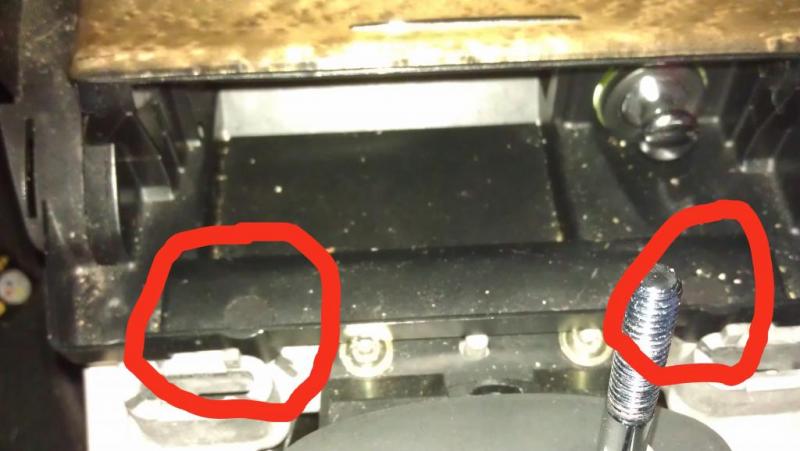

This is kinda what I was thinking was the problem. As I don't have lift to put the car up in the air and check the linkage for the bolts everyone is talking about, I figure I should start with the shiftier assembly.
Can anyone tell me how to remove the ashtray so that I can remove the shiftier assembly. I can't seem to get to the the two bolts that are under the ashtray.

couple of questions. with ignition on what gear is illuminated on shfter assembly. If it is any other gear than park then the bolt has problably fallen out. If the P is illuminated then press brake with ignition on and see if the stop lamps come on if they don't then your brake switch is faulty. If the stop lamps come on then your problem would be shift interlock solenoid. which means shifter. the ashtray does not need to be removed. removed 2 screw covers and both screws and tilt ashtray up. then removed 4 T30 bolts. stick flat head screw driver on pass side of shifter and pry out on cable, should pop off. find green connector to shifter and disconnect. gently lift up. 1 small cable will be attached at bottom. be gentle with cable. can break and then you will have troubles.
how do you remove the two screw covers? You are talking about the little black plastic round things next to the lip of the ash tray correct?

yes. With a small flat head screw driver press at edge of round cap and it will lift a the other edge.
