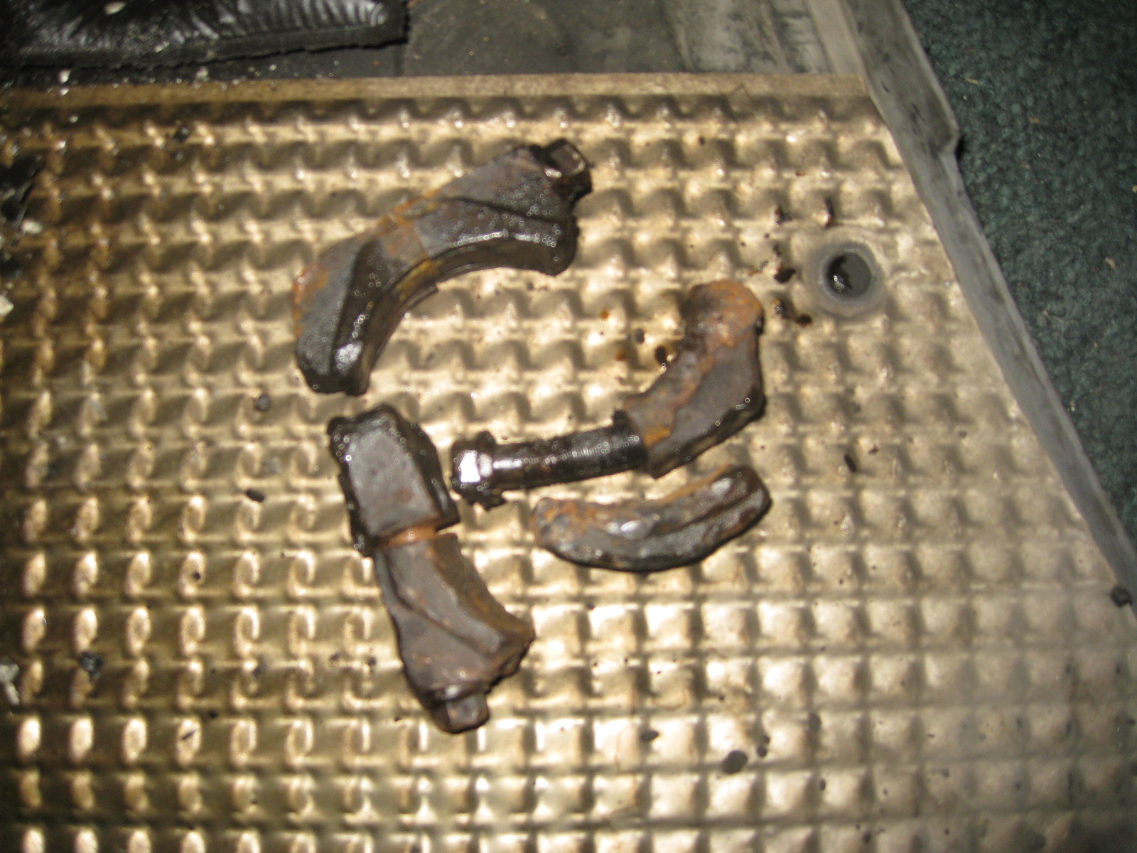

And what does global warming have to do with blown rods and frozen engines
Fact is: STRs do throw rods!!!!

Yes. What led up to it - was it definitely (as opposed to allegedly or maybe) ice inside it?
The person I purchased the car from stated it was due to "global Engine Warming" He stated that the car had been properly maintained, but each year it was running a little hotter and hotter. Others wouldn't believe him. He had lots of data indicating that it was running hotter, but it ran cooler in winter, and occasionally it ran really cold, so they told him not to worry about it. Then one day it blew up.

Likes: 507
From: Hamilton, NJ
That sounds suspiciously like a failing thermostat... That is functioning intermittently, But I have no idea why that would hurt the bottom end.

From: Decatur, TX
Intermittent thermostat (V8's normally stick closed, not open) so "sticky" but not stuck thus running hotter....blows a bit of coolant out the reliefs (maybe he had a busted expansion tank?) low coolant, top up with water, lather rinse, repeat for a few years until the antifreeze isn't capable of it running "really cold?" and pops a hole in the block?
Thanks Tijoe, doesn't sound to be ice.
I was joking about "global Warming" killing the engine. I purchased the car with 2 broken rods, and the seller didn't know what caused the engine to blow up.
