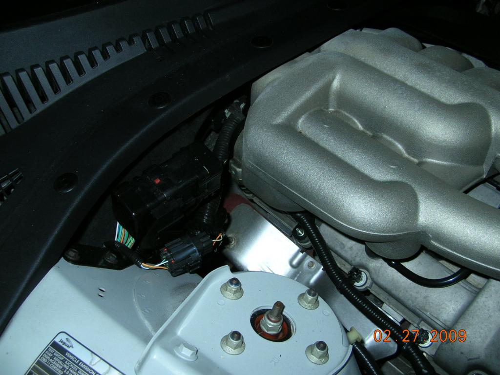

On our '05 when the lower IMT O-ring failed, you could see oil on the rear valve cover stud and burnt oil on the exhaust manifold heat shield. To check for possible leakage, open hood, passenger side (US) use paper towels or clean rag wipe backside of intake manifold, drive then wipe backside of intake manifold again if the is fresh oil B I N G O!
Attached Thumbnails Burned Oil smell when Heater is on.-valve-cover-far.jpg   Burned Oil smell when Heater is on.-valve-cover-zoom.jpg
