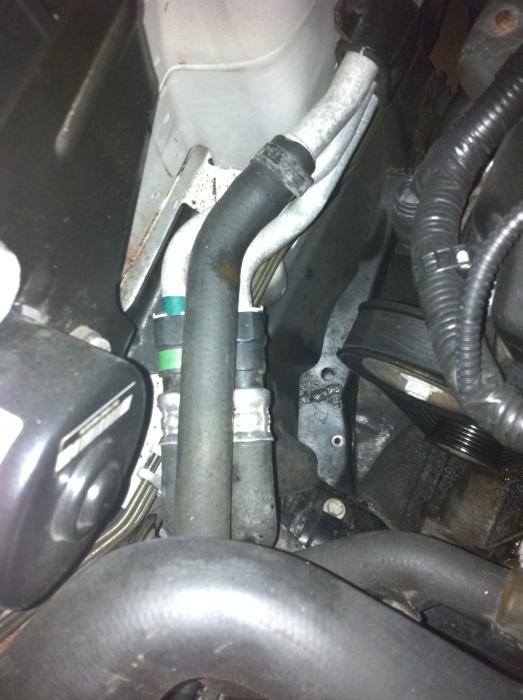

That is the correct DCCV.
No need for a clamp removal tool, use a channel lock plier. I never reuse those pressure clamps, I always replace them. I use the standard screw down clamps and tighten them with an 8mm socket (usualy).
Jaguar sells their own coolant, but it's just rebranded Zerex-G05 at 3x the price. My local advanced auto carries it. If you plan on draining the entire cooling system, you're going to need 2 gallons of coolant (you wont use the 2nd gallon completely) and 2 gallons of distilled water (do NOT use tap water) - any supermarket / pharmacy should have this.
The two lines from the DCCV to the heater core are quick disconnects. Push them forward then pull off to detach. One of them has a green stripe on either side so you dont confuse them. Here's a pic of what they look like:
Take care - let me know if you need anything else or more advice.
George
