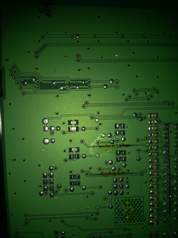

-Checked RCCM board and found a burn trace
Question
Can a bad DCCV burn the trace on the board?

Yes. It's well documented.
It's also repairable and you can install circuit protection to stop it from happening again. Jaguar did not design any protection in so if you run the car with a bad DCCV and it's drawing too much current the RCCM or CCM will eventually be damaged. It does take a while and many people have just changed the DCCV.
It's a DIY repair or you can pay to get it fixed along with the protection circuits.

Yes, it's been posted before with pics and fix ideas.

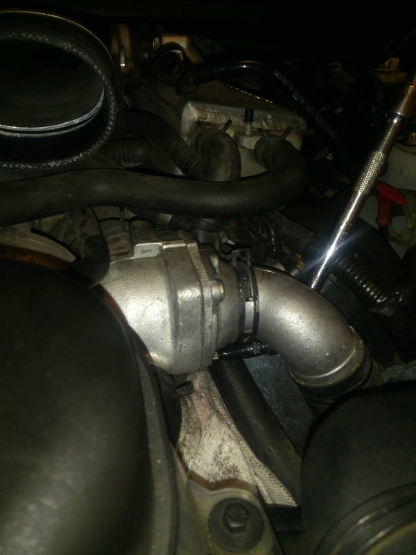

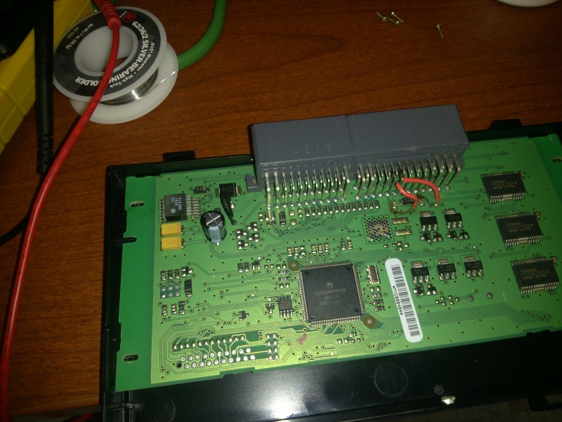

Did a quick jump on the trace (RCCM Motherboard) and only the passerger side had ICE cold AC. I remove the trace because obviously is a bad DCCV and the board was starting to smell.
I haven't found any post on how to replace the DCCV on a 4.2L SC STR. What is the best way to replace the valve from the top or bottom of the engine bay? please dont post the DIY on a 3.0 totally different spacing.

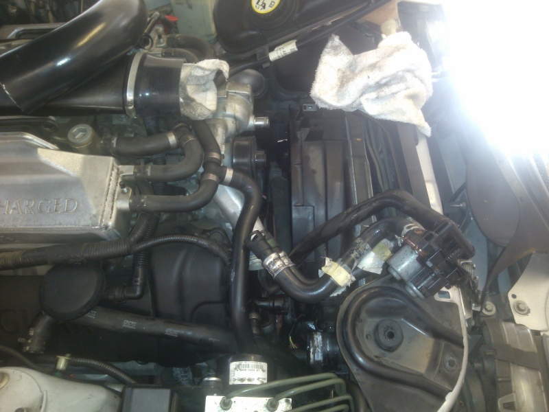

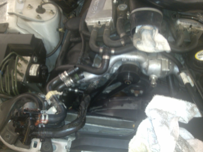

Changed the DCCV, fixed the RCCM traces and while I was at it why not put in a low temp thermostat from eurotoy ... Results ICE cold AC
DCCV used Motorcraft YG-378
some pictures of the action
Thermostat bottom bolt is a pain
Conclusion
Make sure you have this OEM/Hose clamp pliers (25246) | Hose Clamp Pliers | AutoZone.com and some flex socket with that been said I'm ready for summer
