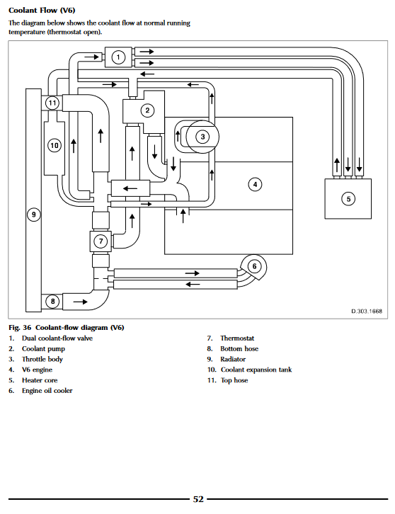

Originally Posted by 1Den
I figured I had placed the lines in reverse order so I switched the lines up again...
Do you have a V6 or V8? You didn't specify, but the arrangement is similar for both. Under the "S-Type Technical Guide" section, open the "S-Type 2003 Update":
JagRepair.com - Jaguar Repair Information Resource
Scroll down to page page 52 for the V6 or 54 for the V8. Here's the diagram for the V6. In both cases, the DCCV is item #1:
As previously suspected, if you were to switch the two smaller outlet lines, the only effect is the buttons on the control panel would adjust the opposite side. Zero effect on engine cooling. If you managed to stop all flow to the heater core, once again that would be zero effect on engine cooling because it's the same as requesting max cold air in the cabin, which shuts off all coolant flow to the heater core. If the hoses were connected such that coolant flowed continuously to the heater core, this would be the same as requesting max heat, also a normal condition.
When bleeding air from the system, don't forget to request maximum heat. This moves coolant through the heater core and helps expel any air there.
