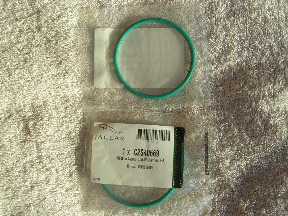

While you have the intake off, change out the IMT O-rings, 2 pieces, dealer only less than $4.00 ea.
