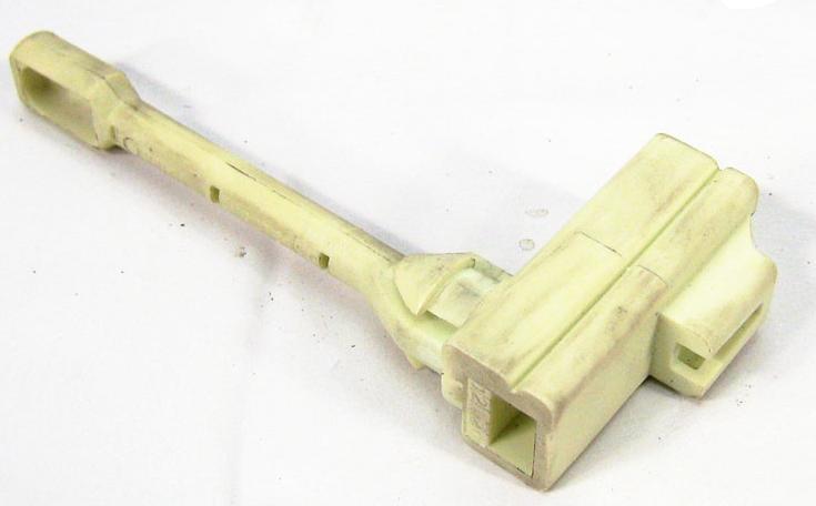

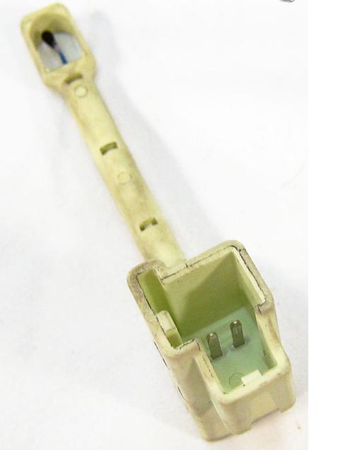

In the thread below there is a pic that shows the drivers side one... perhaps the passenger side one looks the same (I really don't know). When I was looking for this info a while back I didn't come across it either. Good luck!

That was my picture. The long end of the sensor sticks out into the airflow inside the evaporator. The two small tabs or arrow shaped pieces on the side snap into the evaporator housing. I have had the drivers side out and it is visible looking under the dash and above the gas pedal towards the center of the car. The passenger side should be the same but you have to remove a few things to see up in there. You will only see the head which is square white plastic and it will have a electrical plug on it. So it may be a little hard to identify on your back under the dash. I use a LED flash light which is great for seeing anywhere!!
Here is the picture again.
Attached Thumbnails climate control issue with a twist-2003-s-type-r-inside-temperature-sensor.jpg   climate control issue with a twist-2003-s-type-r-inside-temperature-sensor-plug.jpg
