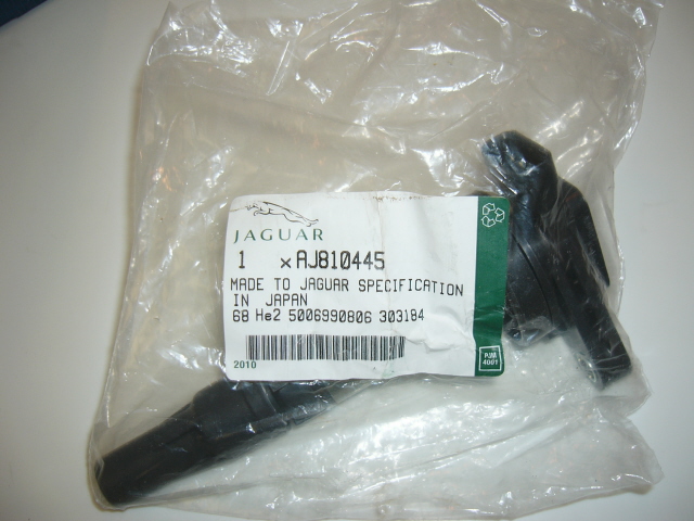

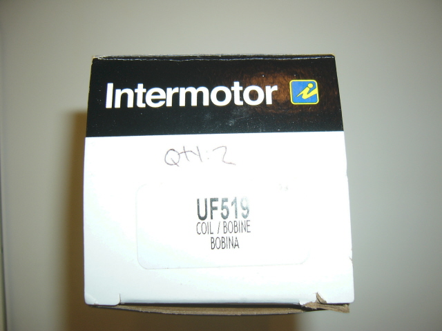

I bought coils for my 2004 4.2l off ebay.They were SMP "products"I paid about $37 each delivered!
They look an awful lot like OEM coils!
In another life I bought SMP coils for my RX8--they were also repackaged OEM coils.
Attached Thumbnails Coil Pack Failure, Again??-smp-coil-box.jpg   Coil Pack Failure, Again??-smp-coil.jpg
