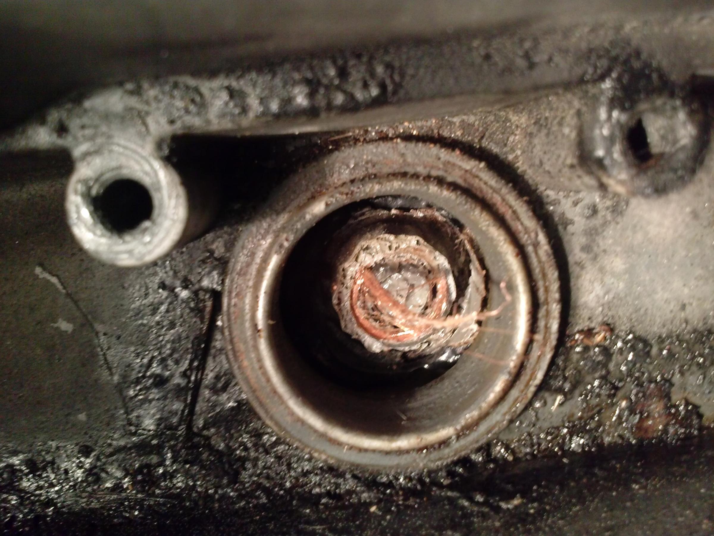

This weekend my Jag, which, by the way, has been running extremely smooth, suddenly went into restricted performance. As I limped home, I started to smell wire burning. My first thought a fire will develop in engine. Nope. Turned out to be a coil pack.
The coil pack melted and basically was being help on by the bolt. Once I removed bolt, I found the coil pack was in two sections with the boot part still on the car. I have attached photos.
My question: Can the car be driven 50 miles to the mechanic without any serious damage? Also, do i need to tape up the 4 pin connector or secure it?

If you are driving it that far I would unplug the fuel injector plug to that cylinder so you are not washing the cylinder walls down with gasoline.
Please tell us how you burned up that coil? I have seen many coil failures but yours sure must have had a LOT of heat generated!!

Why not cut out the remaining boot and remove and replace the plug and install a new coil pack? Use caution not to damage the plug or the tube it is in. You removed the top and the rest should not be difficult. I must sey I have never seen that type of damage I would wonder why it did that, water or oil.

Um, I have NEVER seen a coil disintegrate in that fashion... +1 there has to be a heat condition causing that damage - I'd be more worried about that...

Where did you get the coil pack from? To me it looks more like an internal failure in the coil pack.

Replacing the coil pack would be as easy as patching things up to get to the mechanic. And probably less risky.
The remains in the tower could probably be pulled out using forceps or longish needle nose pliers. You might have to do some twisting to get it to free up.

Unfortunately I am unable to remove the boot that has melted and changed form. It would be my luck I break the spark plug. :-( The mechanics taht put it in are about 50 miles away. I live in a rural area with backyard and weekend warrior mechanics. It is like going into a stick and stab bar. Just don't do it with a car like that!
I thought about the fuel being dumped in that cylinder but I have no idea how to plug it.
The coil is 4 months old and physically different in size, but it may only be smaller due to the coil pack itself.
I read somewhere that the harness that runs to the firewall can move a little, thus rubbing and wearing out jackets of wires. I do not see any looseness in the harness but i am going to recheck.
I am nervous about driving it. The distance is straight highway until the last part which it 2 miles.
I guess the part was just defective.

It won't hurt to drive it but unplug the injector harness so you don't wash your cylinder walls with gas. I have driven in the past with a bad coilpack and it drives like a turd, but really doesn't do much damage.

Well after much scraping, picking, pressing and cutting, I got the melted plastic out. never thought I would combine the tiny tools I use in engineering to work on this part of my car! :-)
I did end up bringing out the vacuum cleaner, attaching a long tube to the end to use down the hold to clean all plastic bits and debris. I wanted NONE of that falling into cylinder when spark was to be pulled.
