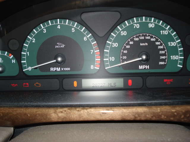

I like the miles!

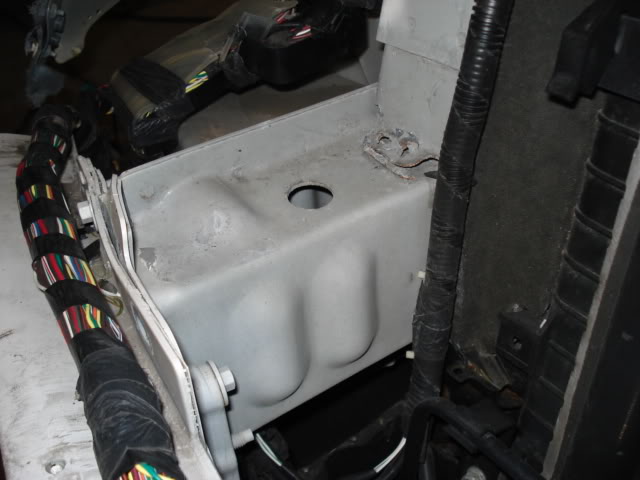

You can see that the lower main chassis rail wasn't damaged. Slight bend in the bumper mounting flange and a little ding in the alluminum bumper reinforcement.
Radiator support/tiebar took most of the impact.
A lot of things like this ABS module were fortunate not to sustain damage. You can see it is pushed back crooked in its rubber mounts but not damaged. The washer bottle is also near disaster but reusable. Some of the plastic on the wiring loom is broken but I can't see any damaged wires.
I would say another 10mph in impact speed and there would be a LOT more damage. When fixing these total loss vehicles you work to repair things the insurance company would just replace. Fusor Universal Plastic Adhesive is your best friend. Not to say it will be a bad repair, but that you trade labor for throwing money at replacement parts. And where parts must be replaced, used is obviously much cheaper than new.

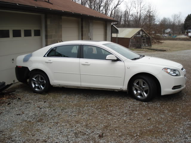

BTW, here's a shot of the car that was to be Laurie's new one.
She was so looking forward to getting a new car. Then she saw the Jag and completely lost interest in the Malibu!!
Well at least she has good taste in cars.

I plan on straightening the suport. New is $450 and I doubt getting a used cut off would be very easy. Then you also disturb a lot more of the factory welds changing it. Anyway it's worth a try. Surprisingly the fiberglass bottom reinforcement or headlamp panel is only about 100 bucks new. Must be a Ford thing cause I've worked on Taurus that have the same sort of setup.
