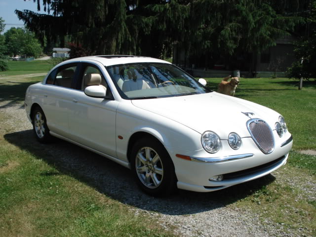

As sugested, a couple finished shots. There should be more on the Pittsburgh Meet Photos Thread now located in the Jag OT forum. I know the other guys took some of it.
At the show, Laurie let the cat out of the bag on the paint issue I had. The guys were having a bit of fun teasing me. What else are friends for? Wasn't a real problem just me trying to take shortcuts. Once I resolved myself to painting more area and blending, it came out great. I know better but thought I could cheat a little...NOT!
So Laurie has her Jag and is so proud. I think I created a monster though. I never saw her polishing and cleaning on a car as much as this. And if anyone gets too close to it, she's ready for attack mode!!
Thanks for all that followed the thread and all the compliments. If you look at the dates, realize that I wasn't working on it the whole time. The Subaru turned out to be much more of a project than the Jag plus some customer work to pay the bills.

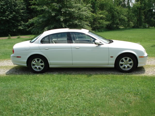

Bit of a difference from what you started with.
Nice work, the car looks great.
