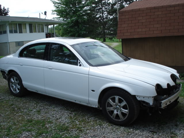

Paintwork done & on to reassembly.
To borrow a line from Chris Rock....It's all right cause it's all white.
Looks good!
