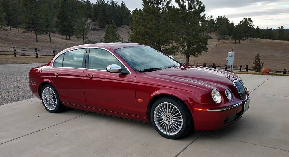

Taking possession of a red, '05 S-Type 4.2 VDP with 71,000 miles on the clock - a two-owner car - in a couple of weeks. It'll be my first Jaguar after having some fun with Alfas the past 5 or 6 years. I'm buying this one pretty much sight unseen but it's got a clean CarFax and the seller seems a guy who knows his way around cars. When I get it back to Seattle the plan is to take it to our local Jaguar guru known as "Jag John" for a run through.

That's a beautiful looking car in red with the touches of chrome. As stylish if not more stylish than most Alfa's of the same period and many beyond.

That is a beautiful JAG-U-AR. I'm looking for one as well and have identified a couple of 3.0's. Would prefer a V8 4.2 but the 3's seem really nice. One in blue and one in black. These tend to be old people cars so are driven carefully and well maintained. Prices are quite low right now even in these crazy times, as no one wants these cars, even well maintained models. Test drives show them to be very stable, excellent handling, and very quiet.
