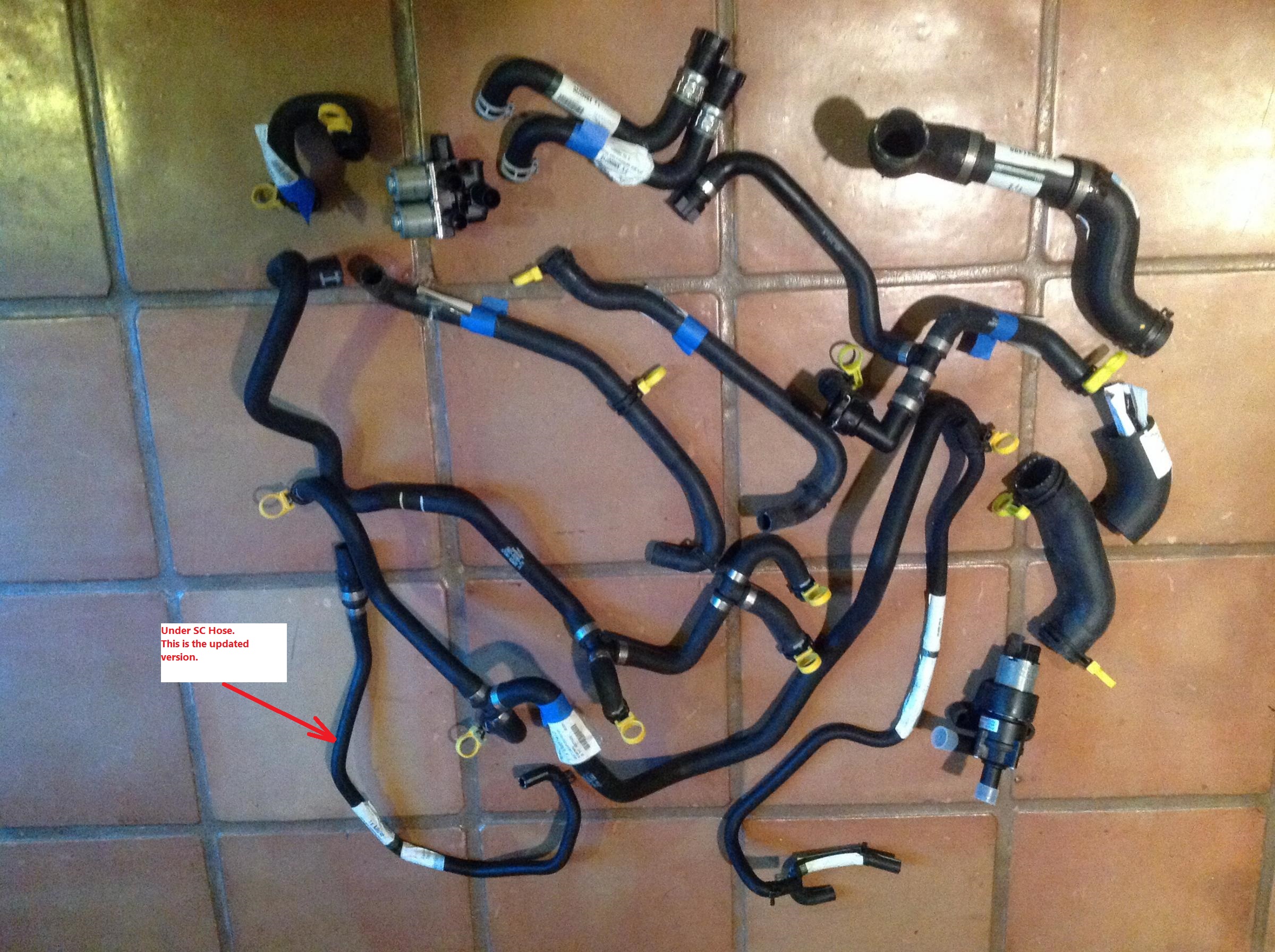

I had a leak from maybe the DCCV or auxiliary water pump. Decided to replace most hoses and finally have the parts after several rounds of orders from several sources. Car has been down for a couple of weeks and I've been able to drive the 1972 XJ6 which also developed a coolant leak then a faulty alternator (GM unit). Had to drive the F250 for a while too and just returned from Death Valley vacation with the truck so can get to fixing the STR.

Have a look at the under the supercharger hose. It's notorious. If that one blew posting a photo of it here and in the main thread for that issue would be helpful as evidence of what goes wrong.
I've not been hit with this so far but based upon what I've read this hose is not made right. So check out that thread and think about doing something preventative. One guy talked about having it made up in silicone and he was in the automobile manufacturing business.
I'm looking at that collection of hoses and gasping just thinking about what it all cost.
And if you haven't learned by now be forewarned any plastic involved in the cooling system (probably elsewhere as well) is of very poor quality. My second coolant tank is leaking once again at the very same spot.

Thanks. I just started my teardown yesterday and have included the removal of the supercharger to replace the hose underneath. I was originally going to skip this due to the effort however I have the luxury of having two other cars (XJ6 and F250) to use while I try to do the job right. I'm just now looking into sourcing the additional parts for this new effort.

It looks like he has the updated under SC hose. We don't know what was changed but the one I got from Jaguar is a one piece hose. No metal where it changed diameter. That spot seems to be where they usually start leaking.
I think you are missing a few hoses but maybe not?
I marked the SC hose in question.

I'm looking at the hose in that picture and I see two metal bands on the larger end so how is this now one piece?
Also, I have seen one(1) failed hose and it was in the larger section. I have been asking to see others and have not. So maybe I missed those?
Has it really been established that this is where the hose fails?

Sorry, no I was unclear. The one I have from Jaguar is one piece. But it looks like they have now changed it to a two piece hose with the metal bands on it.
I am hoping this was due to the difficulty in replacing this hose. I may even buy this new style one because when I checked it was less than $30.
Never been established but the pictures that I have seen posted, the failure is at the large end of the hose.

Originally I was not going to undertake the SC hose replacement and apparently ordered the SC hose by mistake. I have not found a single comprehensive source that has: 1) exploded diagrams, 2)part names; and, 3)part numbers. So yes I am likely missing some hoses too.
I have now undertaken the work and have just gotten as far as removing the EGR valve. Couple questions:
1. My EGR looks to be in good shape. Should I consider replacing it?
2). Next step is to remove the two pipes from the air intake elbow. Pressing the plastic clips,does not seem to allow them to slid off. Any tricks? I hate to get too rough.
I sure hope I can put this all back together.

Well your EGR valve and tube do look very good and I would be like you are now. Do I replace or not? If I had them on hand then yes I would change them. My personal plan is to have it all on hand if I need to do it. I have everything BUT the EGR stuff right now.
The tube looks to be stainless but several people have reported getting a hole in the tube so I wonder where it corrodes at?
I find the water pump to be pretty easy to get to because it's on the front of the engine. The 4.2L does not have many water pump problems aside from a few that have leaked. I would not change it now.

All the ones I've seen photos of are the two piece design with the metal bands and it's the large portion that fails.
So I'm still confused by your comment???
