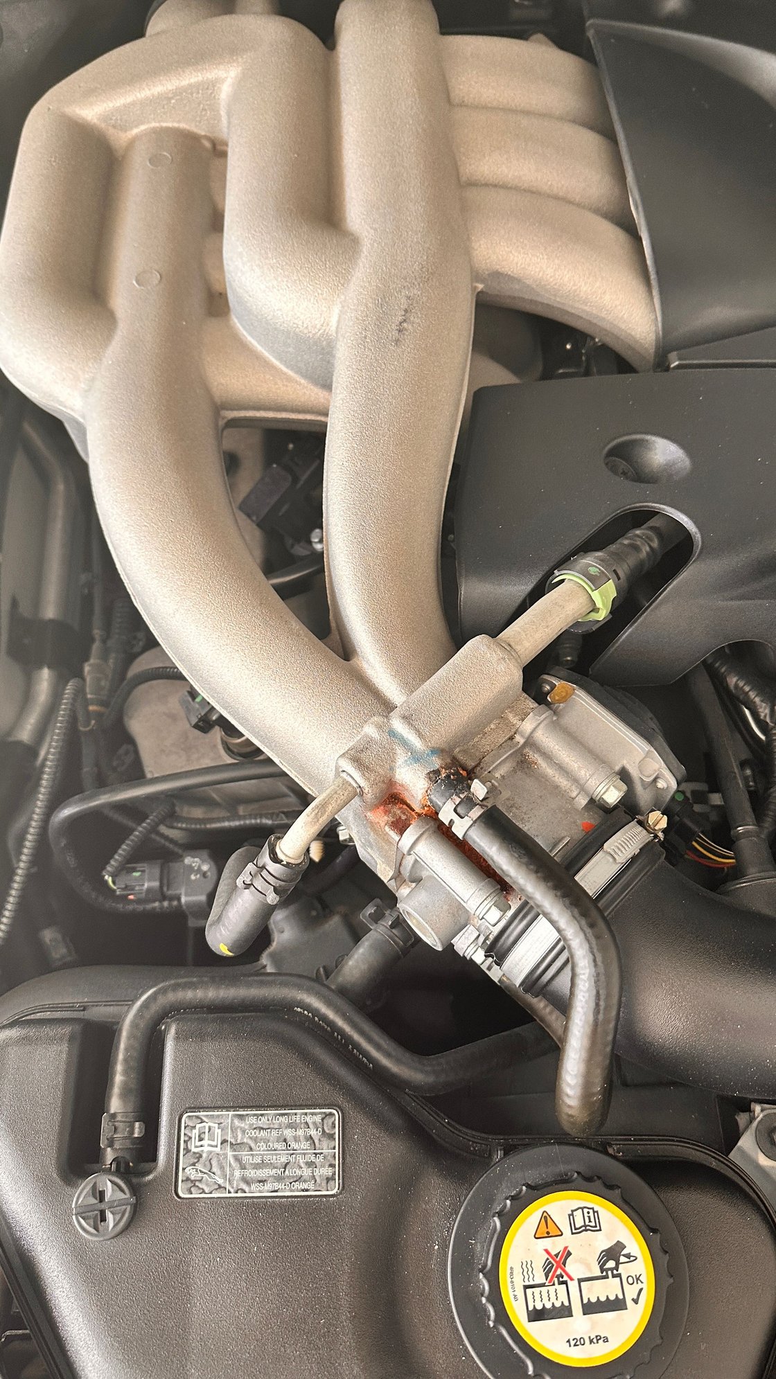

Hi Guys, looking for help here . as I was reading this thread about the leaky orange marks and found this on my S-type '08 could it be a the DCCV valve leaking?
if not, any tips on what's causing this is appreciated!

In a word... no. That is your throttle body.
The DCCV is located at the base of the radiator on the right side of the car.

Anyway: Your coolant leak is just behind the throttle body on the air intake. Place a bowl (to catch the coolant) under that spot and pull the clamp back (with pliers) and remove the hose to check out why you have that leak. It looked like that on the flange of my water-pump. It was utterly corroded. One would hope that if you remove your hose and clean the metal surface underneath that you do not find corrosion-hole in there. But if there are depth-depressions (=not yet holes) I personally - if you do not want to buy an new intake - would clean the metal properly with a small rotary wire brush on a drill and apply "liquid metal", let it dry and sand it until smooth.
And there would be a lot of crap stuck on the inside of you connecting hose there: Clean that out thoroughly When all is finished, put the clamp back on AND add a second hose clamp. Check coolant level and refill with the correct coolant. Red coolant would be correct - check it has the right spec. Ford Spec WSS M97B77. You could also use a certain yellow coolant, but I don't want to confuse you too much - I wrote a thread about it:

Peter, thanks for your detailed information and steps to resolve my issue. I’m kind of relieved that my issue is NOT related to the dreaded DCCV valve and I will attempt your suggested steps tomorrow and will report back the results.
