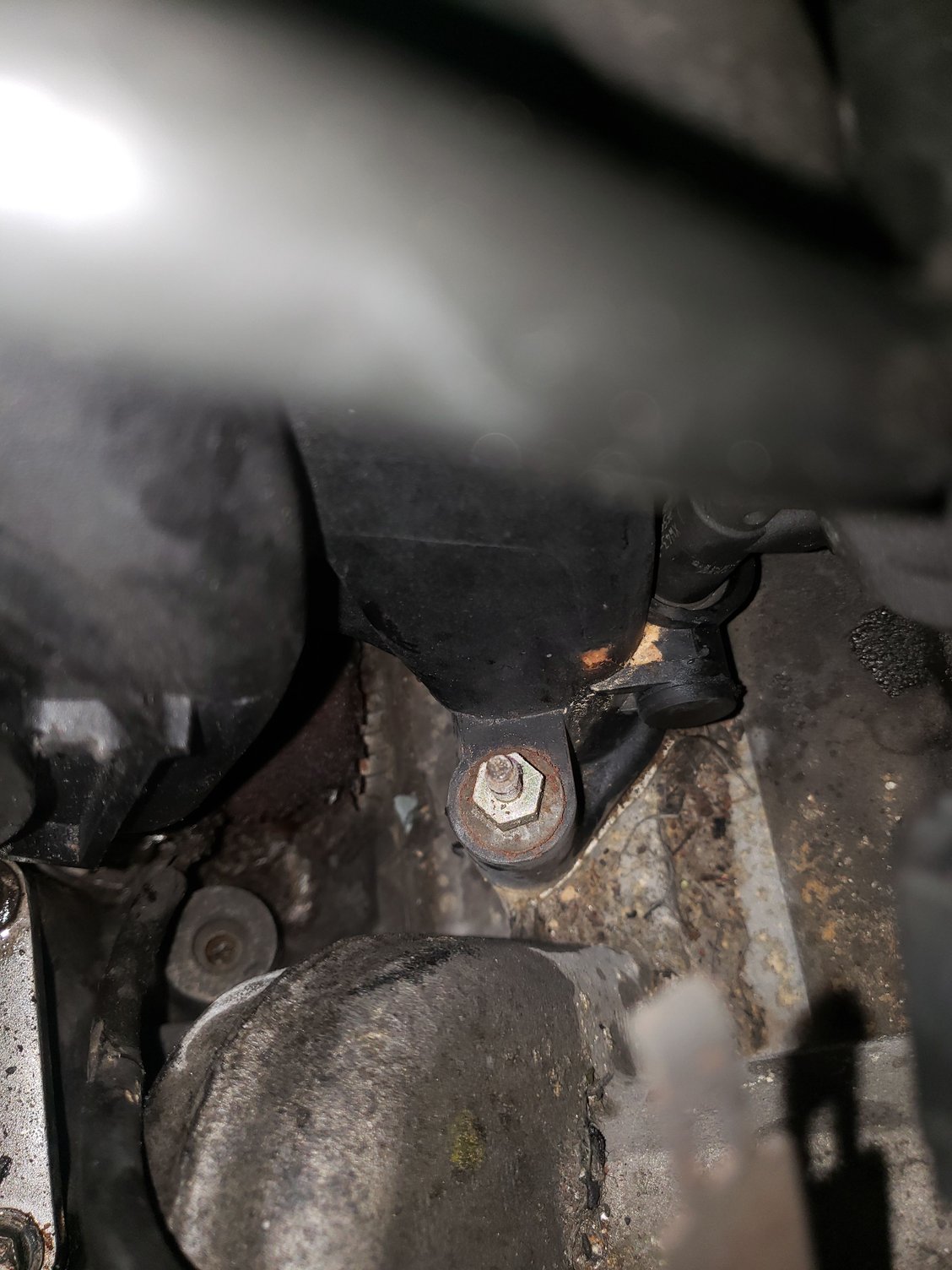

Ok so I'm about 20% in on this manifold and my body is already aching. The drivers side is easy assuming there's three bolts plus this one. So eight bolts total? Lmk where to start with the throttle body. Fingers crossed I can get it done without bringing in reinforcements

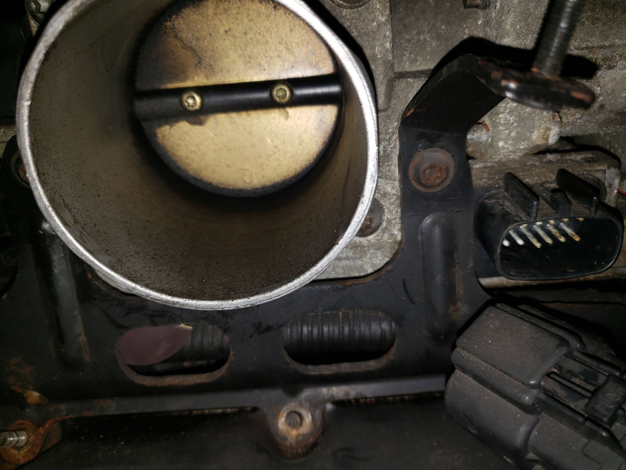

Guessing these torx need to be removed to get the throttle body off. No luck with the manual and was unable to download and install jtis.

I would spend some time and get the JTIS installed? What did not work?
Free JTIS
I hope you don't plan to remove those screws on the butterfly? Leave them alone.

No I meant this rusty torx screw lol. yeah for some reason I can't install jtis I will try again today and hopefully I can get this manifold off this weekend
