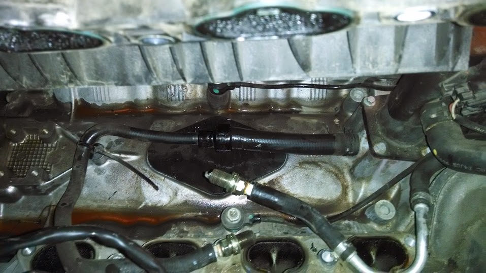

So I took off the rear plastic and the cross brace. I found a pool of coolant on the passenger side valley between the cylinder head and intake manifold. I used a fluid pump and remove the pool of coolant. I started the it up and the pool filled back up. What I cant see is where the coolant is coming from. Under the car it is defiantly coming out of the converter housing plug and running down both sides of the housing. I see the hose in the back but it don't seem to be leaking. Is there a hose under the intake manifold?

Been reading up on the forum about a hose that's under the intake manifold. What is that hose called or part number? I'm going to pull the intake manifold off like the manual states. I'm going to need new tb gasket, and intake gasket to do the job so far. Any suggestions on maintenance when I pull the intake off? Is there any else to look out for when pulling the intake?

I found the hose under the intake causing my coolant leak. I touched the fitting and the larger hose came out. There doesn't seem to be a barb fitting in there. I cant seem to find the part with the number on it xr839w539aa f190WQ . I don't want to wait so Im going to get a barb fitting for now. Thanks for heads up about looking there.
Attached Thumbnails Coolant leaking Converter housing plug and-img_20140315_194449858.jpg
