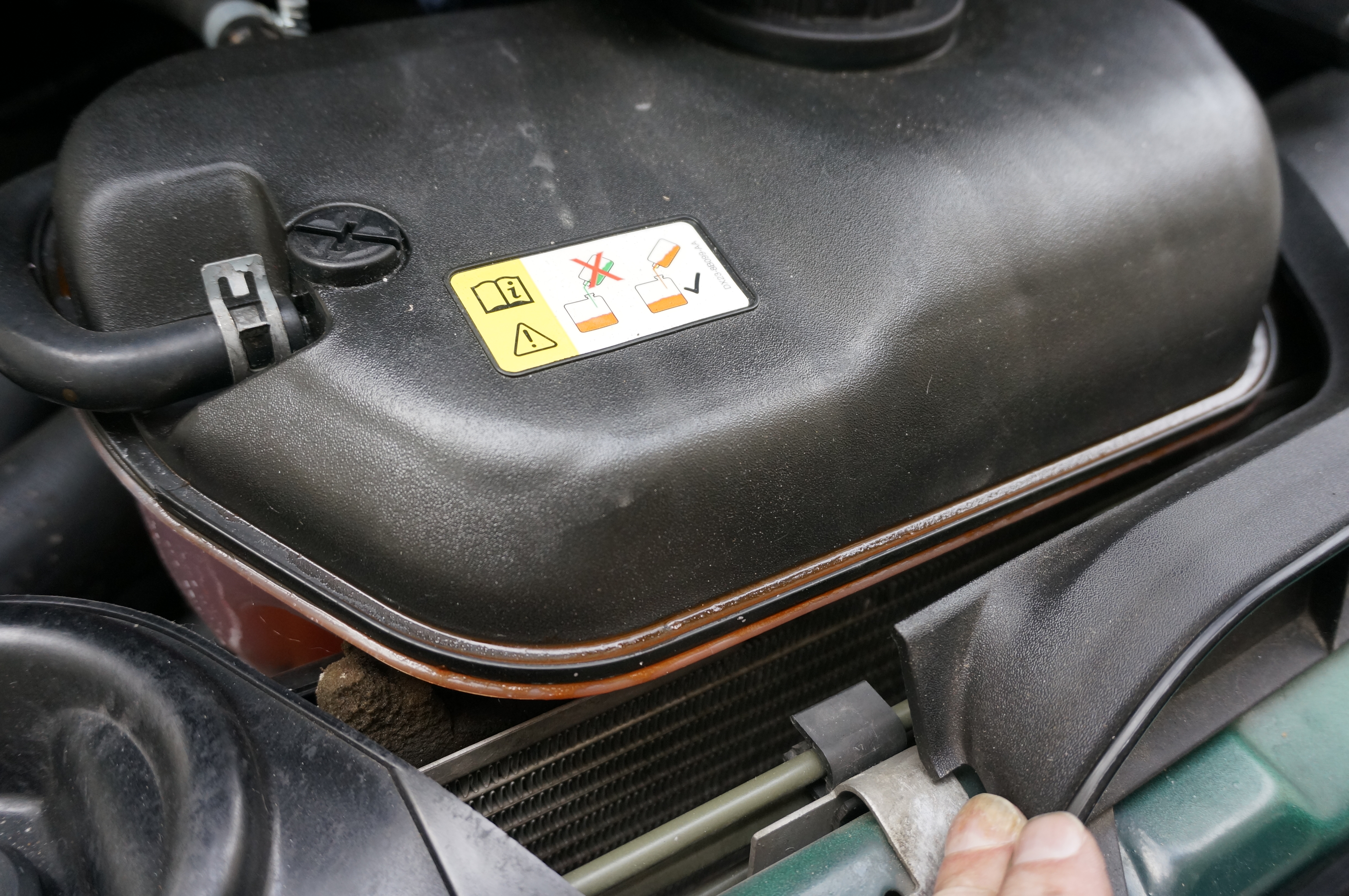

Or your new tank could be weeping some coolant. EVERY tank (3) I've had in mine has weeped some coolant along the edge but it's a very small amount so I just ignore it. The last one I replaced I had just pressure tested it too and I couldn't find anything testing it out of the car. It completely failed a month later when a fitting snapped off. They're complete crap. BMW owners have similar complaints.
But yes I can smell it when the car is hot on a warm day. On mine it's a bit more complex tank because of the supercharger pump circulation but I have thought about making one out of aluminum. That's a difficult fit in that crowded engine compartment.
Keep checking your coolant level when cold. Mine drops almost imperceptibly but after 6 months of regular use it's down to the low position visual marker.

Here's what I'm getting now after not looking at it for a couple of months.
We have somewhat different cars but in my case at least it seems to begin at the nipple that points towards the rear of the car and then run around the lip.
I've replace all the hose connections to the tank and the clamps and after 3 tanks it still leaks. m Jaguar in this case ... LOL
