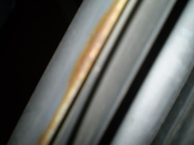

Here are some pictures..... Oh boy
Attached Thumbnails Corrosion Warranty Test-pc120001.jpg   Corrosion Warranty Test-pc120002.jpg   Corrosion Warranty Test-pc120003.jpg   Corrosion Warranty Test-pc120004.jpg

Read the warranty coverage carefully - to be eligible for the six years unlimited corrosion warranty it has to be perforated - i.e. there has to be holes, if it is just badly rusted it probably won't be covered.

Jeff - the TSB deals with water that's trapped below the door by adding a drain hole in the sill. I'll check whether mine has a hole and for signs of water/rust. Maybe some other owners would be willing to do the same? (C'mon Jon lol)
If you want the TSB to help you figure out where the drain holes are, let me know. But have a look at your car: sounds like the hole should be near the edge of the rear sill tread plate (if you have those?), perhaps near/under the rubber seal.
Regardless, this should not happen and I would expect (perhaps in vain) that it be covered. I'd also expect jag corporate to want to know, in case there's an issue they need to deal with globally.

Oh , to be honest that doesn't look good
Still, I think and wish this can be done under warranty . I remember a member in X Type Forums suffered from rust issues but that was a happy end later

Jeff - I've checked and NO drain holes on my 2004 car. Also, no signs of needing any. The door bottom has 2 rubber seals, one is thinnish and curves around the inner rim. The other is a wide straight rubber piece all along but just inside the door's outer lower edge. Both are hidden when the door is closed. Maybe one or both of yours is missing/damaged?
I can imagine water getting trapped between the 2 seals but only if water's there.
If you can tell whether your rust is "surface going in" or "inside the door coming out", it'll help tell where the water starts from.

Well, we'll see what Mike (At Jaguar Cleveland) says. This is going to be a real test for me to not freak out.... See, I can handle mechanical issues...I expect things to fail and need service. But this kind of stuff. Like I've hinted before, there are other fit and finish issues cropping up with this car. But nothing like this!
John, I would go ahead and post the TSB. It would just add to the thread and that isn't a bad thing. I don't think it is related since you say it deals with the sills. This looks just like what used to happen to the old American iron. Water would sit in the bottom of a door and basically rot it from the inside out starting with the weld between the skin and door frame. My Dad had a 78 Chevy truck that was always clean and garaged. The doors got so bad that the bottom of the door skins started to peel away from the doors. My friends and I used to call it "flappy". Since the doors would flap in the wind as we drove it down the road... I thought those days were done..
Realistically, I think there is a flaw with the door and it's seals since this is the door that I had all that trouble with after I got it. No other door is showing anything even remotely similar.
Thanks everyone for their feedback as well. If anything it says that I'm not loosing my mind and it is pretty bad...

The TSB is about draining water out that's entered via the inner door panel. But it's not the way to fix your problem. You're not losing your mind and the door's history will be the real issue. It ought to be covered (I sincerely hope).

I really can't believe that is happening to an 05.
I had a Mercedes that rusted in several places - on the door where the molding met the door, on the trunk lid under the license plate etc. All of the rust was covered under the corrosion warranty.
I know you are in Ohio and there is a lot of road salt on the roads, but I'm in NJ and suspect we have just as much. I bet they cover the rust without much hesitation.

Wow.... I nearly spilled my orange juice looking at Jeff's photos. I expected to have to struggle to see a few rust spots. But man, that door edge is flat-out corroded. I don't see how Mike can escape having to provide a new door for you. I agree with your hypothesis that the previous issue with this door's trim has been allowing water to leak into the door for quite some time. When Mike's crew takes it apart, I'll bet that's exactly the conclusion he'll come to. We'll see....
If it is indeed a faulty trim installation issue, you can't blame the car. But you should blame the guy who did the work. That should help you to recover some sense of trust in the build quality again. Maybe just not enough to want to stay in the car beyond your Select Edition warranty running its course in June 2011....
My wife's in her Lexus today so I had the opportunity to check our S-Type's doors very carefully. Not a microbe of rust, and all rubber seals are completely intact....
I strongly believe that your previous door trim problem combined with your salty winter Ohio roads caused your issue. Keep us posted on how Mike treats you. Again, if poor trim installation created your rust, you can't blame the build quality of the car for this....

Talked over the phone with the service manager today. He needs to have the district manager for Jaguar inspect it because of the gravity of the situation.. I did stop by the dealer and one of the service advisers saw it...I think the quote from him was "holy sh*t!". So, I think it is a bit more than some "surface rust".
Anyway, the district manager is supposed to be in on the 19th. I just hope Jaguar is as easy to work with as my dealer..

How long have you noticed this? Just curious as it doesn't seem to me at least that things could corrode this badly overnight.
I really don't think you will have much of a problem having it covered. The thing is that door is rusting from the inside out, and they may want to just clean up the surface, sand / fill / paint. It may look ok for a while, but the rust will come back. The only real repair here is a new door that has no rust in it.
