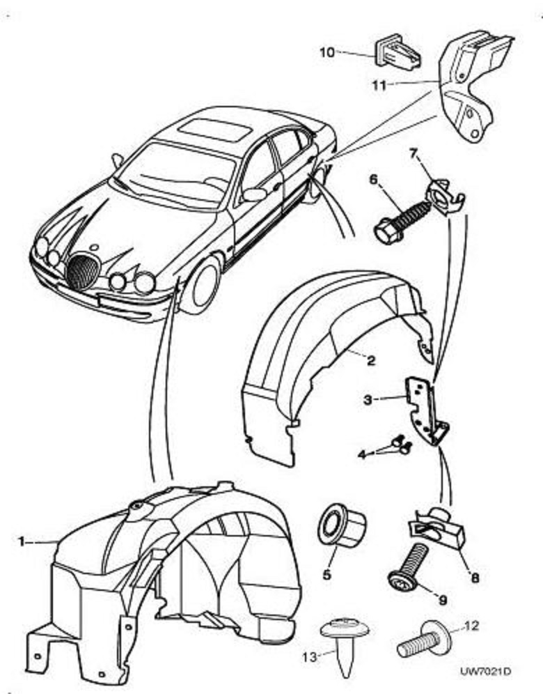

Checked the other side, and no damage ! also would you happen to know of the rear wheel well liner covers the whole wheel well or just like 75% of it ?
Old Jan 13, 2014 | 11:30 AM
clubairth1's Avatar
Community Influencer
Posts: 12,031
Likes: 3,336
From: home
Yes. It looks like it.
That is one part I have never removed but the JEPC does have a good diagram. See below.
