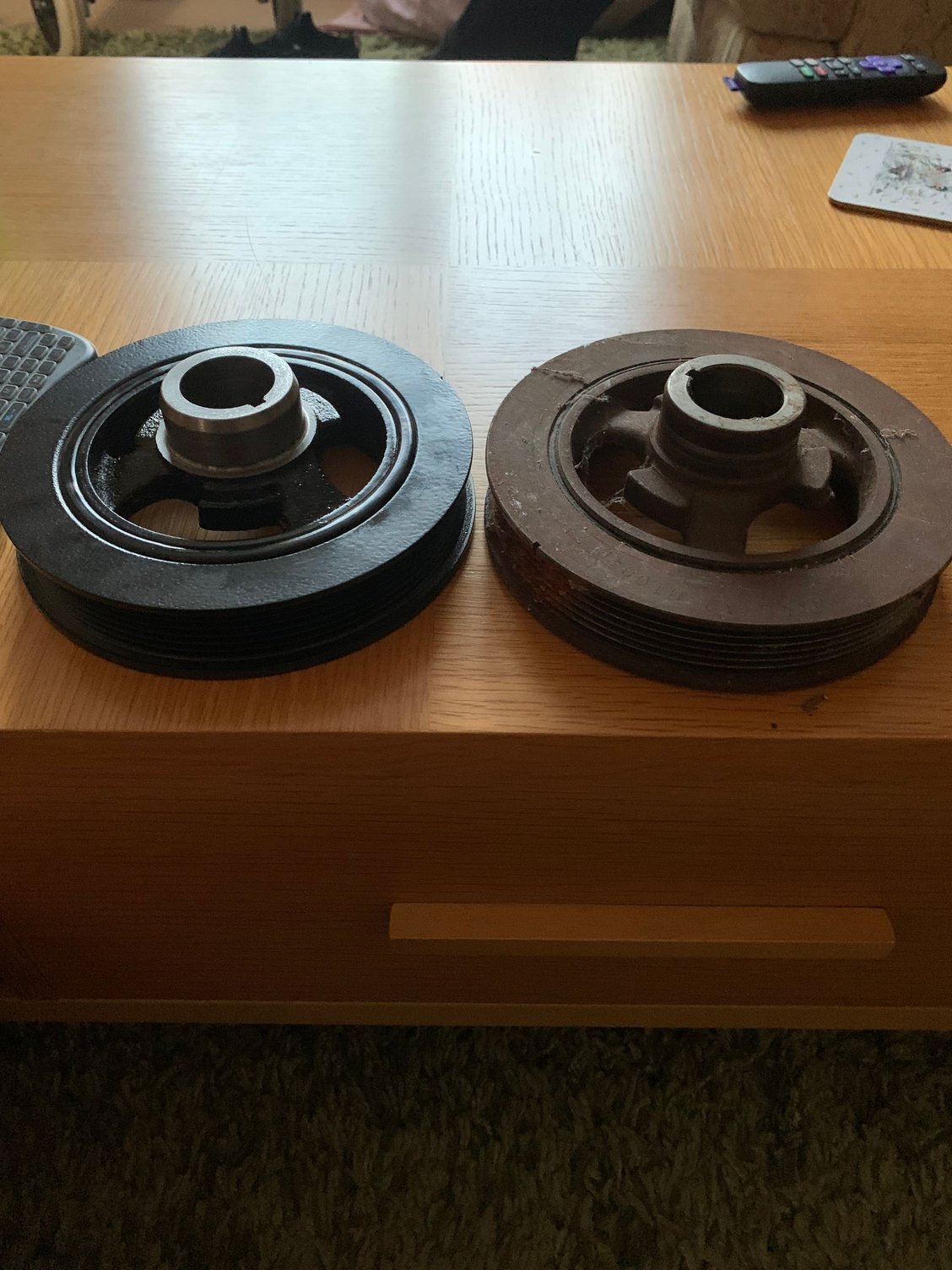

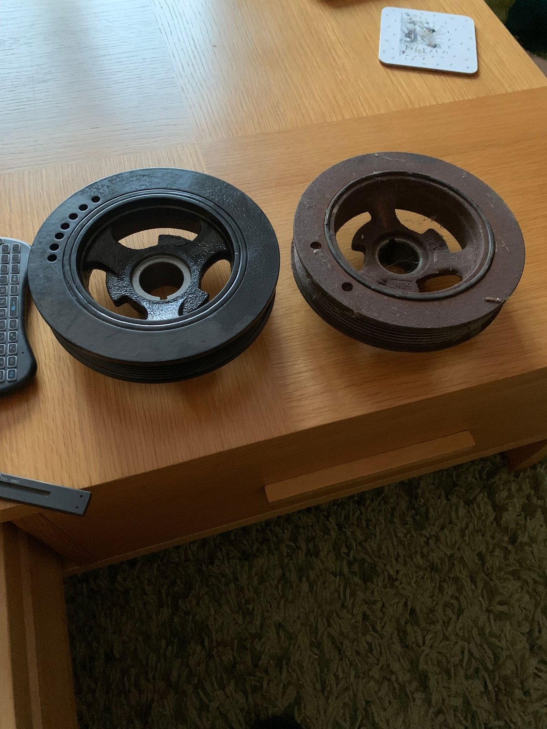

🎉🥳 The new Lincoln LS pulley arrived today. I can confirm its dimensions are identical to the Jag part! I measured using a vernier gauge.
The part I ordered online The part I ordered online
That's the best news I've had all month!
Thank you so much for sharing this information, and congratulations on finding the right part!

The Lincoln LS is much closer to the first gen. S-Type than the Mazdas or Mondeos, and some other parts are interchangeable. Always worth cross checking the LS parts.
