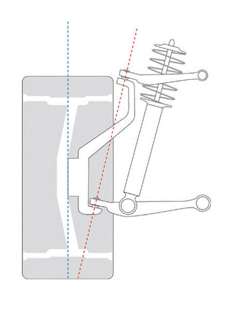

Another ill informed post. The reference to bump steer was as one of the side effect of too much positive castor. Just like you have by installing the wrong upper A arms. Also the KPA is changed by using the 2000 A arm profile but you clearly have no interest in technical stuff, so we will pass that one eh.
The 2001 I owned from 2001 to 2006 was a reliable ride. The steering and suspension dynamics were marginal at the limits and it ate tires. Apart from that I never had any issues in 120K miles.
See the measurements and profile of the correct 2003 - 2006 A Arm. Perhaps you could post the measurements and profile of the early A arm.
Attached Thumbnails Daughter's Home: Fit new Upper Control Arms to the 03-arm-dimentions.gif   Daughter's Home: Fit new Upper Control Arms to the 03-kpa.gif   Daughter's Home: Fit new Upper Control Arms to the 03-p1020561.jpg
Regarding the above, I believe you said it about as well as it could be said:
The A-arms I fit were accompanied by the following marketing literature:
Fitment: Jaguar S Type 03-08
Jaguar XF 09-12
Jaguar XFR 10-12
Meets or Exceeds OE Specifications
1 Year Unlimited Warranty
The results? Until now, I've hesitated to hold forth out of respect for those who may've spent 4X as much or more to fit the OEM arms. I simply didn't want to embarrass them, or needlessly saddle them with buyer's remorse, but the painful truth is, for less $ anyone could experience, "an S-Type that rides quieter and smoother, changes direction more eagerly and handles with more agility, with an unexpected bonus of a boost in fuel economy of just north of 10%"
Why?What?How? As previously stated, I have never owned the pre-2003 car, I have never owned nor possessed A-arms for the pre-2003 car, nor have I any interest in obtaining, measuring, or discussing same. The MY2003 predecessor is essentially an entirely different car that looks identical on the exterior and shares many of the same durability weaknesses. I don't know much about the model and tend to shy away from discussions of it. However, when I come across some hapless poster that no one has bothered to answer whom I can see is headed down the wrong track, I'm not averse to giving him(or her) a slight bump-steer back on the right track; to wit, I noticed this one still unmolested after 3 days' time: https://www.jaguarforums.com/forum/s...7/#post1522904
So I offered a gentle correction: https://www.jaguarforums.com/forum/s...7/#post1525150
Perhaps you could get in touch with that OP, who clearly had possession of the pre-redesign arms and took some measurements? If so, while you have him(or her) engaged, please scold him(or her) sharply about the sins of fitting sub-$50 A-arms, aka "cheap Chinese junk!"
Now that we've cleared up that these A-arms have naught to do with the pre-MY2002.5/03 car, here are some pictures indicating how far the ball joint moves. Let me be clear, that the camber distance is identical between the arm removed and the one that replaced it. It only moves longitudinally - caster is the only parameter affected. I stated earlier that it moved aft. That was my best recollection at the time. Now, on reflection, I am really not sure. Could be it moved forward. We could tell from the photos, maybe some of you still can - it is easy enough to tell which is new and which has just been removed from the car - but I don't remember which side is which in the pics. Sorry! I do recall measuring each side, and as can be seen, one ball joint moved near as makes no difference 3/4" while the other migrated nearly a full 1".
The method utilized was somewhat crude, yet suitable for satisfaction of curiosity, which is all I was really doing at the time. I had an aluminum tube lying about that fit snugly in the bushing ID. I inserted it through both bushes, flush with a particular one:
