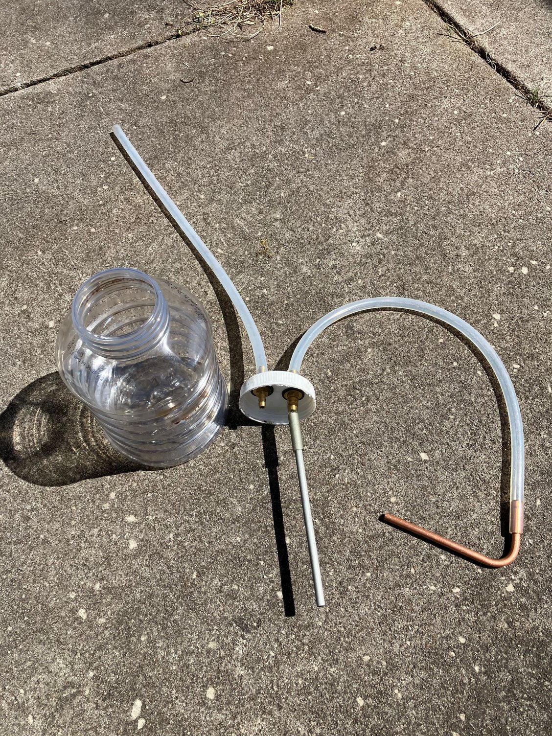

For many years, I've had a homemade drain bottle, similar to your sketch. I've used it primarily for brake fluid and coolant, so 1/4" hose was perfectly adequate for those thin liquids. I'll probably build a version with larger hoses for thicker gear lube.
​​​​​​It's built from a plastic applesauce jar, emptied in case I have to be specific. Through barb fittings (with gaskets) pass through two holes drilled in the lid. A piece of rigid tube, connected by a short flex hose, extends to about 1/4" from the bottom:
I did not use a shop vac as you suggested, but rather a handheld automotive vacuum pump. Here's a newer example of what I have, the type used to test vacuum actuators, etc:
After a few minutes, I noticed there is no need to continually cycle the handle. Draw about 10 in-hg and let it go. Check every few minutes and build up more vacuum as needed.
When it's time to refill, switch the hose to the exhaust port on the pump. Initially I was going to rinse out the drain bottle with solvent, but realized that would make little difference. Let it drain upside down for a few minutes and call it good. The inside of the differential was still coated in old gear lube. A smidge left in the bottle and mixed with new wouldn't hurt anything.
If I were to do this again, I would have used a longer hose between the bottle and pump. I could have watched the gauge from the comfort of a shop stool, versus laying underneath the car.
One suggestion to pass along: Do yourself a YUGE favor and buy a small roll of silicone tubing. For similar jobs, I've always used that generic clear plastic tubing (PVC?) from my local hardware store. This stuff is fairly stiff and it seems you're always fighting it. Silicone tubing is comparable to a wet noodle and so much more pleasant to handle.

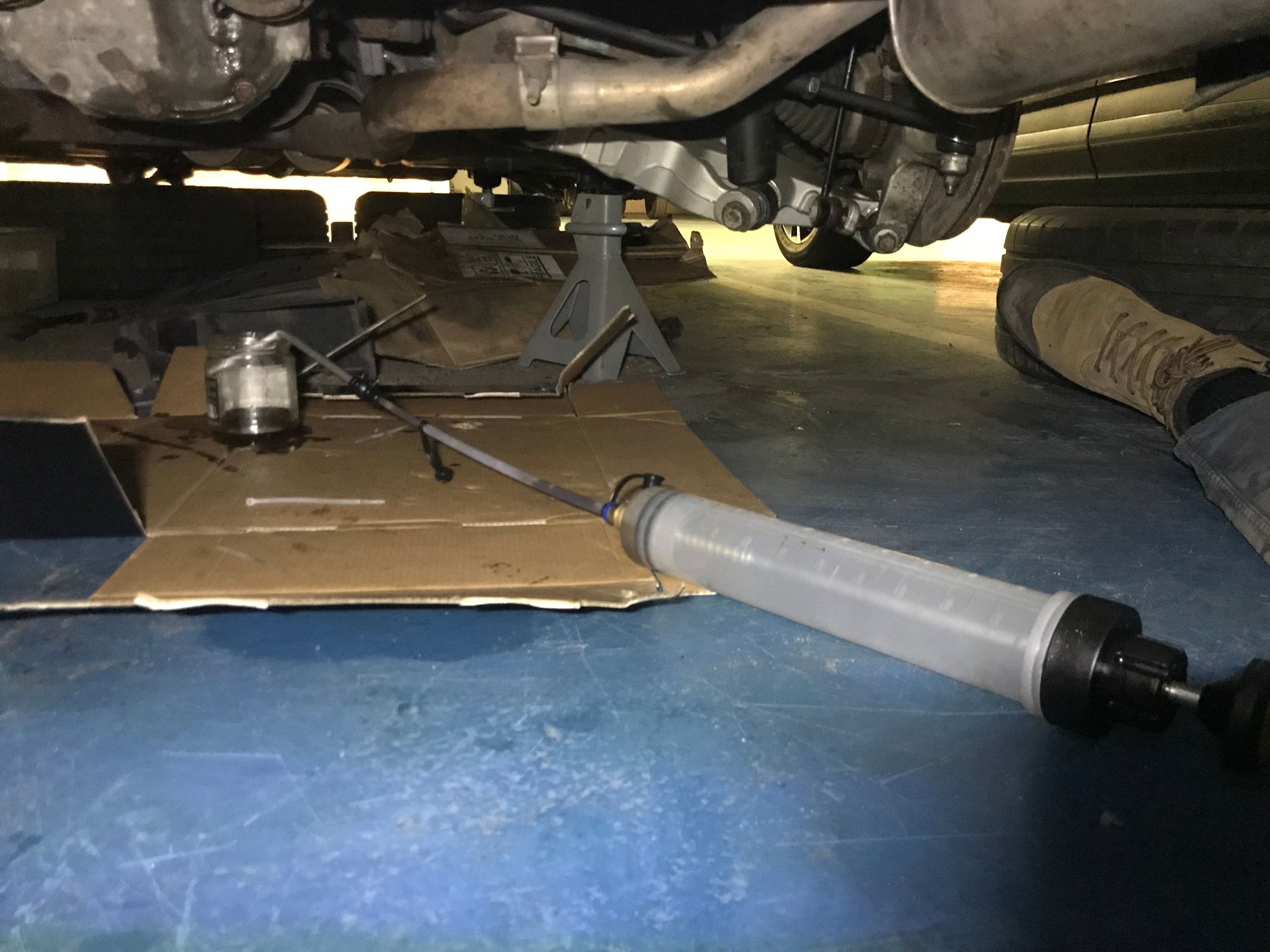

you guys convinced me to give it a go ! Bent 10mm aluminium tube, cheapest amazon fluid syringe, and a bit of elbow grease Got 1,35 liters out !
