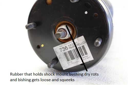

Undo the shock from the lower control arm. Open the trunk and move the carpet out of the way to get access to the 4 nuts that hold the shock/spring assy. (coilover) in place. Remove the nuts and the whole unit can be removed. You probably can fit the lower part of the shock into a press or the puller that you use without having to remove the spring. But if your shock bellows is rotten and/or the upper shock mount rubber and bearing are bad, you will need a spring compressor to remove the spring from the shock. The upper mount assemblies are still available at not too bad a price.

LOL. Not to sure if you are serious or not. He should just go to Auto Zone and borrow a coil spring compressor for free.
The coilover spring is actually under a lot of load being that it is compressed about 3/4"
Best to use a spring compressor.
