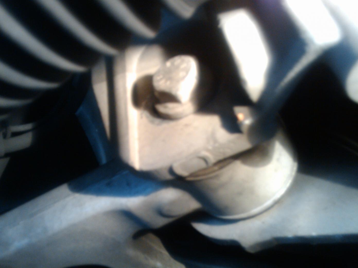

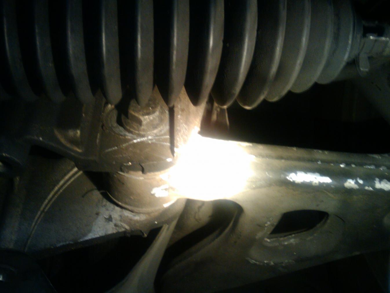

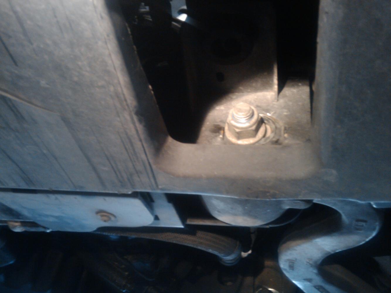

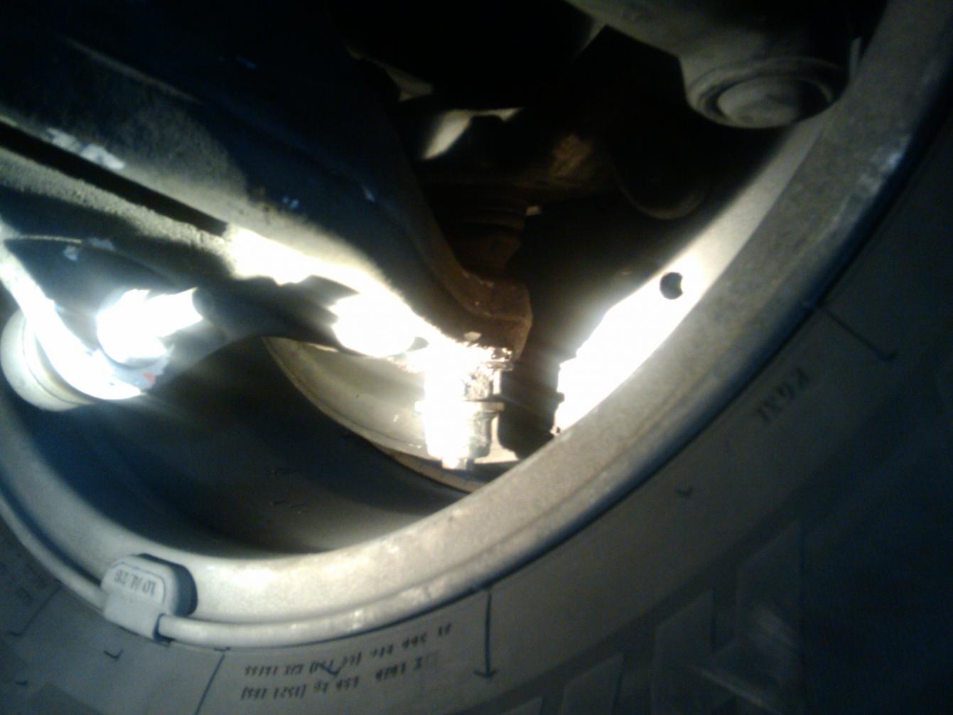

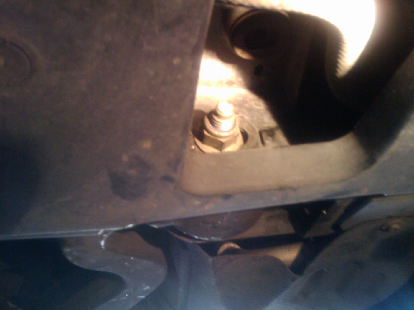

Default Update.
An update.
Today I took her to a shop that specialized in tyres, steering, etc. Told them the story and asked for a diagnostic.
RH Lower ball joint has two nuts.
Nuts and ball joint stud spin in lower control arm.
Need to replace lower ball joint and lower control arm.
It seems the first shop wasn't able to tighten the ball joint enough so they placed a 2nd nut on top.
Total cost $2,243.43 with tax. $1516.21 of that being the right lower control arm (XR8-046022)
Small claims court here we come.
Does anyone know where I can get the right lower control arm cheaper or is this a dealer only part?
THANKS guys.
Mark
Attached Thumbnails Dreaded Alignment-2010-08-14-10.21.40.jpg   Dreaded Alignment-2010-08-14-10.22.35.jpg   Dreaded Alignment-2010-08-14-10.23.12.jpg   Dreaded Alignment-2010-08-14-10.23.51.jpg   Dreaded Alignment-2010-08-14-10.24.08.jpg
