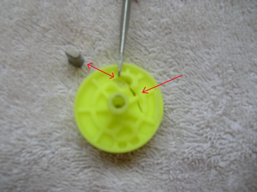

To me it sounds like your lock actuator gear is broken (see pic below), if thats the case I would from experience have the whole mechanism replaced with a new actuator rather than going used. Better be sitting down when the Jagaur dealership quotes you a price.

My Honda was doing the exact same thing. joycesjag is correct, it is very likely that your door lock actuator is done for (it fixed my Honda, too). Get a whole new mechanism as joycesjag mentioned.

It may just be coincidence that the (pictured gear above) failed. From my time of screwing around with our rear door actuator your symptoms sound very familiar to me.
Joyces locks acted the exact same, locking then unlocking immediately after. The remote would not work nor the lock button located in the dash. The only way to lock the vehicle was manually.

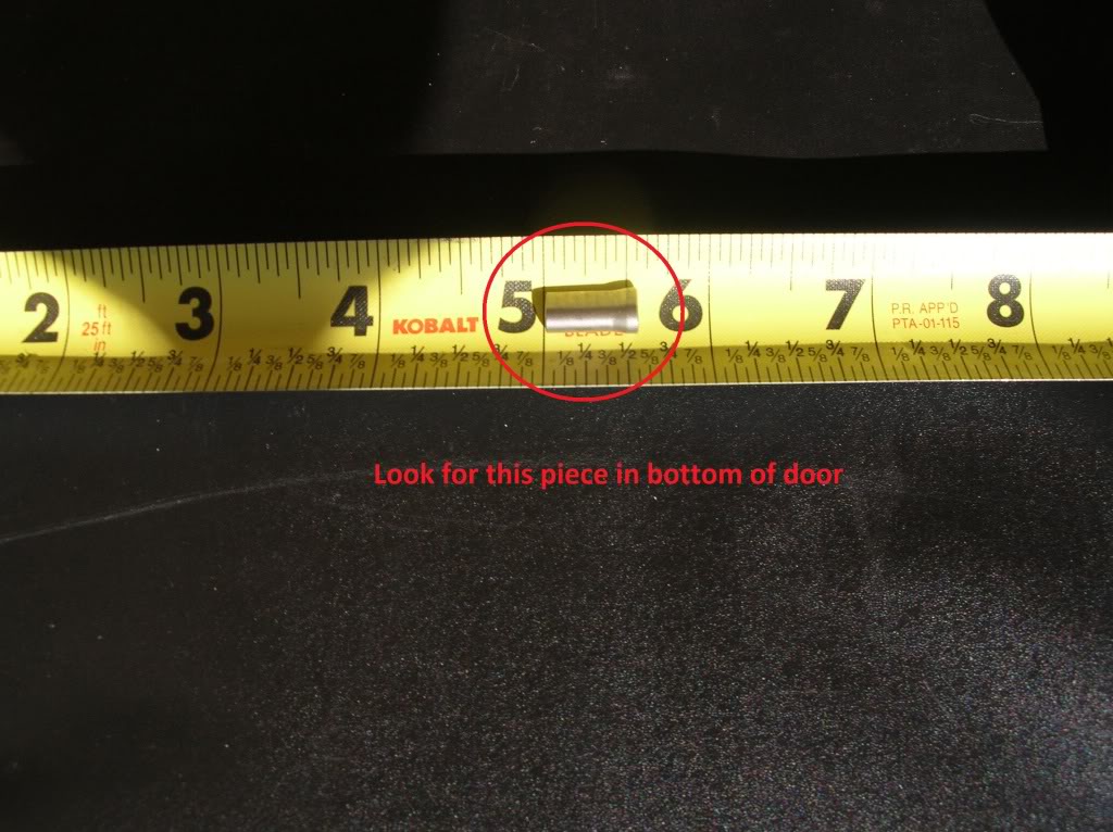

I am not sure about the front actuator but if you DIY you could remove the door card (instructions in the "How To's with pics) and look for this little piece in the bottom of the door:
That would be a tell all.
It might be worth a trip to the dealer to see what they have to say (I hate to say that) but shelling out $300.00 for a new actuator plus labor is a hefty sum of money. You can find used actuators for about half that of new but its your call.
If you can put your ear to the exterior door handle and lock the doors you will hear the actuator rotate, a very slight pause then rotate again, its that gear (again pictured above).
With the little pin missing (2nd pic above) the driver door module isn't going to function correctly.
